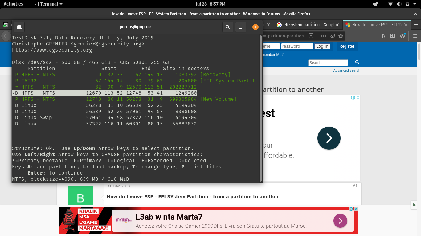

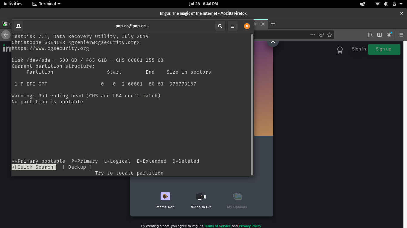

Hi guys!
I have laptop thinkpad x240. Yesterday I tried to install pop os (linux os) next to windows 10 which had partition "C" and "D" then in the step of partition I selected gpt and then apply then all partition is gone. Now my 500go hdd is unallocated no os. A friend suggested to install testdisk I did via usb bootable linux.
I want to recover the first five partition so I can back to windows 10 with all my files. Please help me how especially I am afraid to do a mistake and lost everything.
it gives me only 4 partitions to be green. is it possible to recover system too and boot to windows 10 without losing data like favoris in browser.

You did not link your pictures correctly.
Please upload the pictures using the functions "Attachments" on the bottom of the page.
Do not try to update your notebook before having duplicated your drive.
When having fear trying to repair your drive, duplicate it first using ddrescue.
I don't understand what "pop os" means.Yesterday I tried to install pop os next to windows 10

I count roughly 800e6 sectors which is approximately 400 GB for your first five partitions asssuming they are full. 320 GB may not be sufficient.
