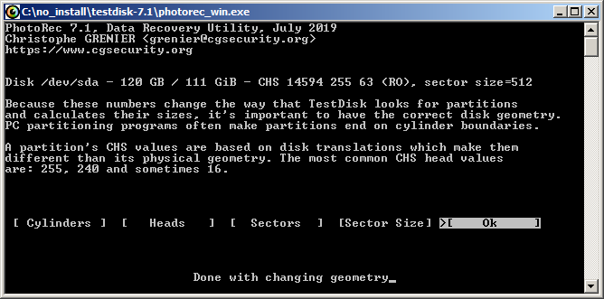

I've been trying to understand if changing the geometry options will get me more results.
Photorec -Geometry.png (18.93 KiB) Viewed 9040 times
Photorec tells us what the geometry is used for.
Your partition is well-known and defined because you only formated your drive.
Therefore you should not touch those CHS-parameters.
