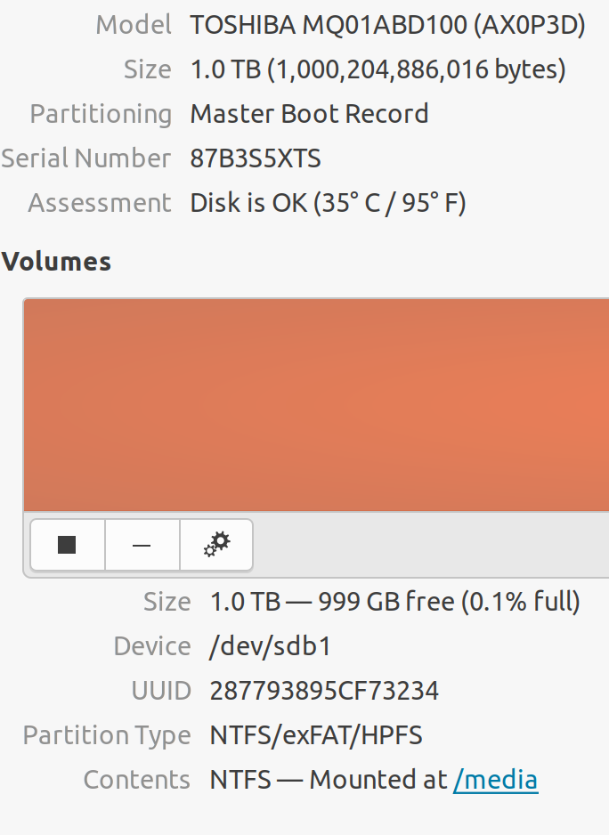

The internal HDD I am creating the image file on details are below:
Is it possible that other file format would help improve the ddrescue speed?
