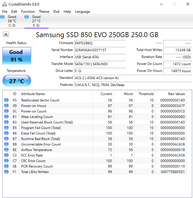

Please upload your image of CrystalDiskInfo using the attachments tab below.

Your testdisk log is full of read errors. You should reinstall your operating system on a new disk.
Use the "p"-key to examine the partitions after the initial analysis already and try to recover personal data that might be on your disc.

Sorry I didn't even see the attachments tab there but please see attached below.
Yes I'm definitely getting a new hard drive and will reinstall Windows. My main hope here was to essentially try and be able to clone my old C drive so I retain all of my software and settings. Do you think this is a possibility?
I know it probably a long shot but setting up from scratch is mammoth effort so I thought I'd ask those who know better what my chances were :D
There are two Partitions from 1161216 to 487327349 and from 1161216 to 488396799 that list my C drive files when I press the "p" key. So they seem to be duplicates but with slightly different sector lengths. One of them says "NTFS found using backup sector" while the other is just "NTFS".
There are also multiple [Boot] and [EFISECTOR] and a single [Recovery] that list files while all the other partitions discovered give a files damaged error.
Crystal Analysis.PNG (55.79 KiB) Viewed 7106 times
Thanks for your help.
