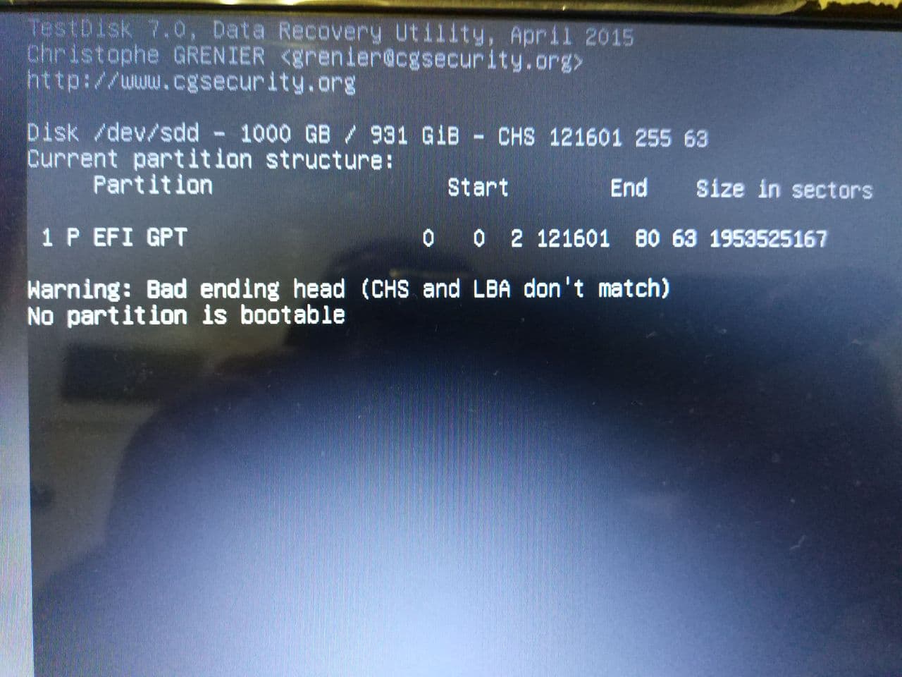

in the mean time,i attach some screens of the situation
after disk selection,autodetected intel partition type (please note chs and lba don't match) also note the erroneous gpt from my mistake in proxmox

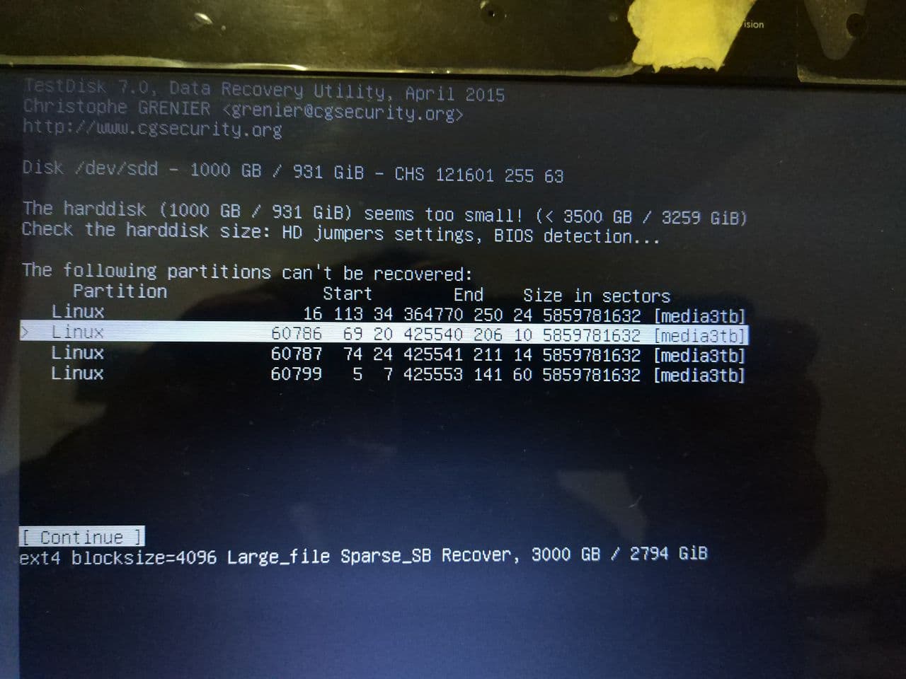

Quick search finished
and this is the results...it found another 3 partitions...
i move the selector down for you to note the sparse_SB recover that in the first partition is NOT present but in the last 3 yes
after quick search finished.jpg (96.73 KiB) Viewed 10810 times
i'm starting to think that, since this problematic disk is PROBABLY the first of the array , it contains the entire allocation table of all 3 disk of the array and consequently testdisk says "you can't restore 3000Gb in a 1000Gb disk"?? makes sense to me...
i'm in your hands now,cause my experience is not enugh to proceed

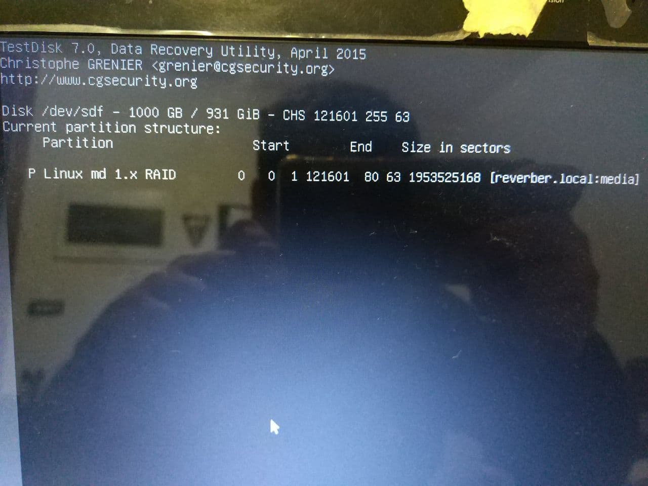

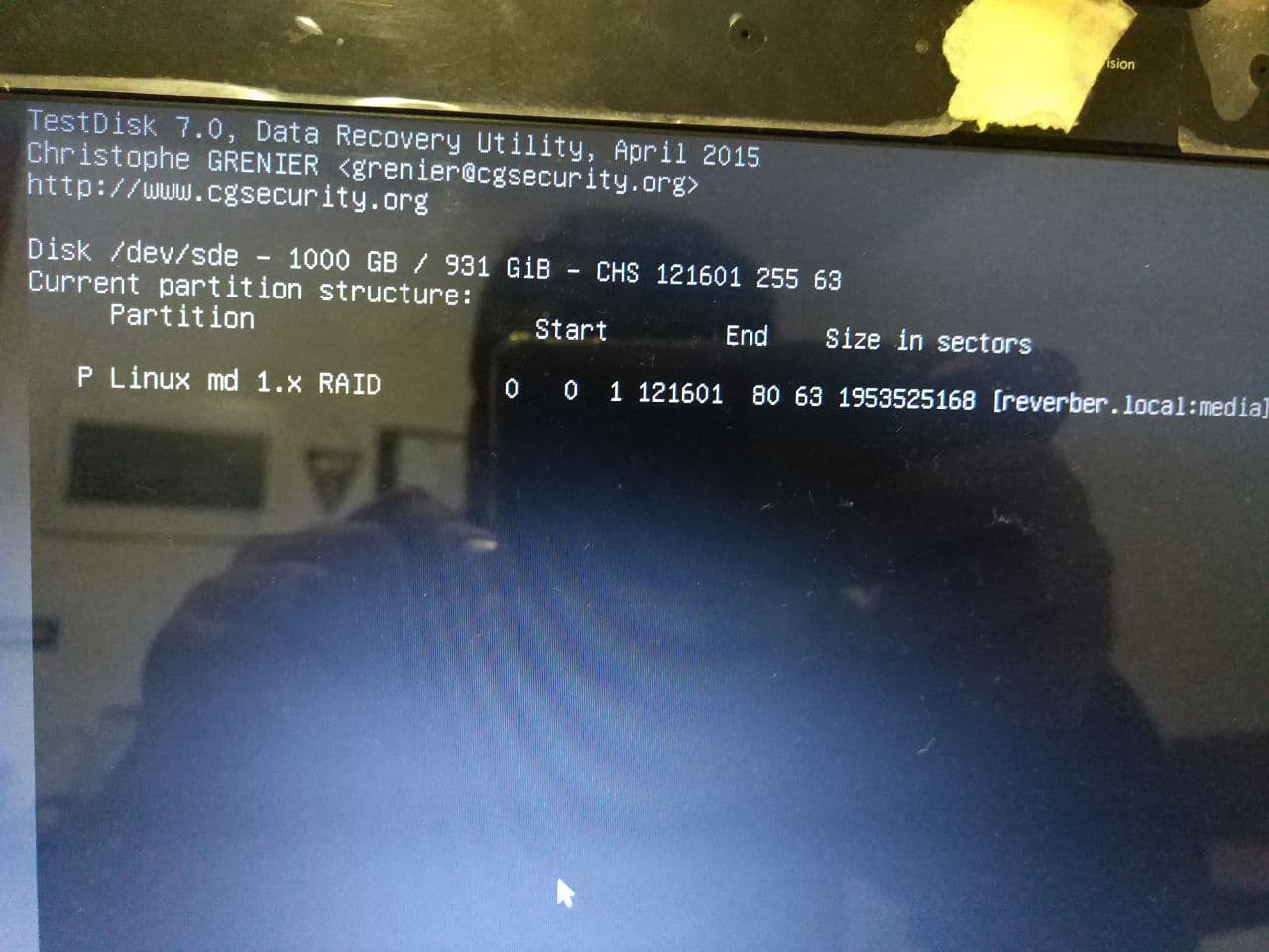

so,another 3 pics for better helping others helping me:
here's the sde disk
here's the sdf disk
sdf_quick _scan.jpg (86.94 KiB) Viewed 10772 times

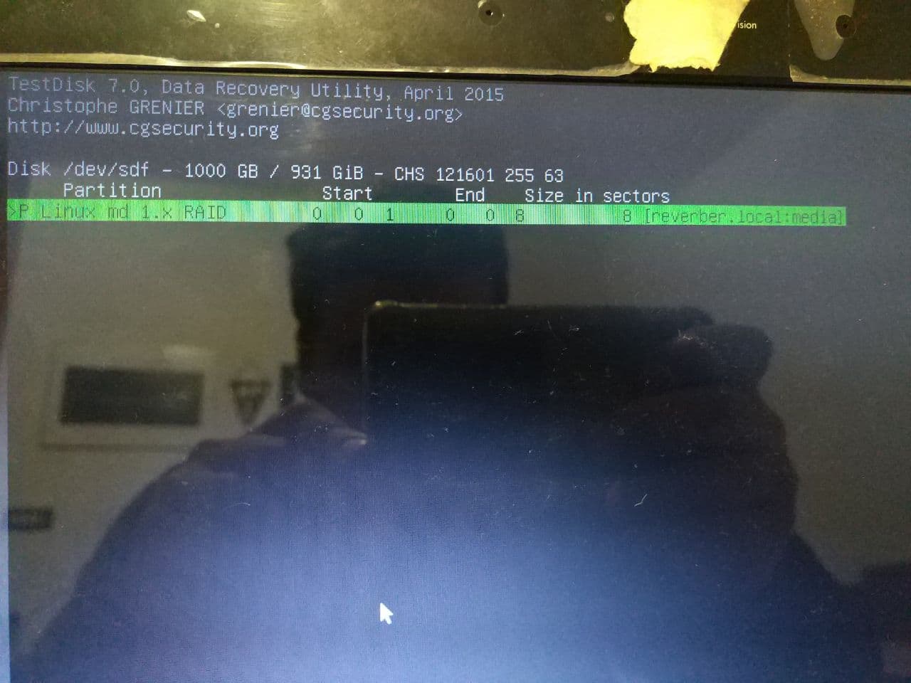

and here is also the same sdf disk with correct identification linux md 1.x raid and values 0 and 8 that honestly i can't understand
once again please help
