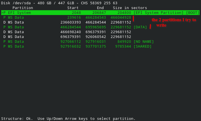

Hi, so to tell you whole story:
(all of this is done from a USB stick using Manjaro, and the partition table type is a EFI GPT)

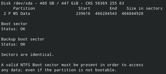

I wanted to move a partition (it was a large windows data partition), and the software crashes when it was working. Then I have found more or less how to recover the partitions which were broken, after backing up them in an image. One of it, when I write it and close testdisk, is able to mount and navigate, but when I reboot the system don't shows anymore the partition, and I have to write again, and again. This is my Windows system partition. In testdisk, when I try to go in the boot sector recovery for this partition, it shows me this:
Status: OK
Status: OK
Sectors are identical.
but it also shows this for the other partition, except for the EFI system partition, for which one the option is not accessible.
Moreover, when I try to analyse, the current partition structure with a quick search, it shows me the 2 Windows partition (system and documents, NTFS) as deleted, when the boot and shared partitions appear as primary.

Right, sure
after analysis:
the partitions I try to write (which ones appear again as "Deleted" after, whatever if I reboot or not):
the filesystem utils menu (with selected the partition I want to fix):

the state detected of this partition:
boot recovery.png (18.99 KiB) Viewed 8348 times
