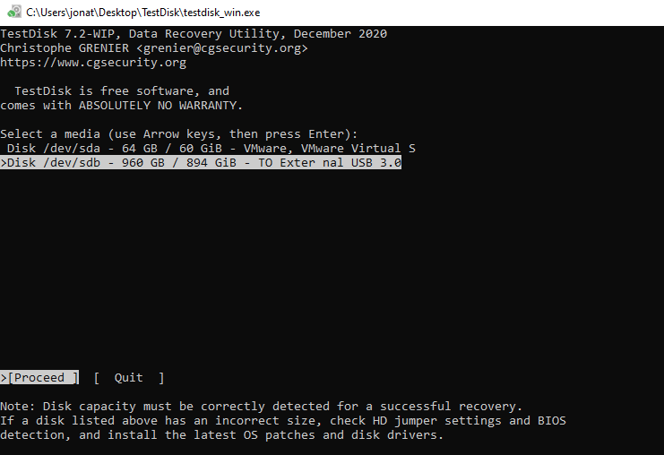

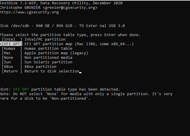

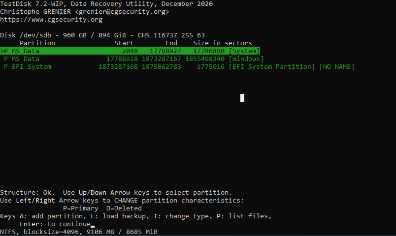

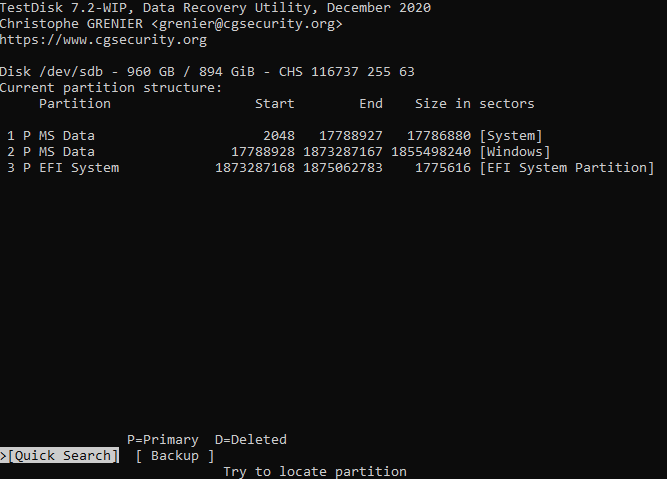

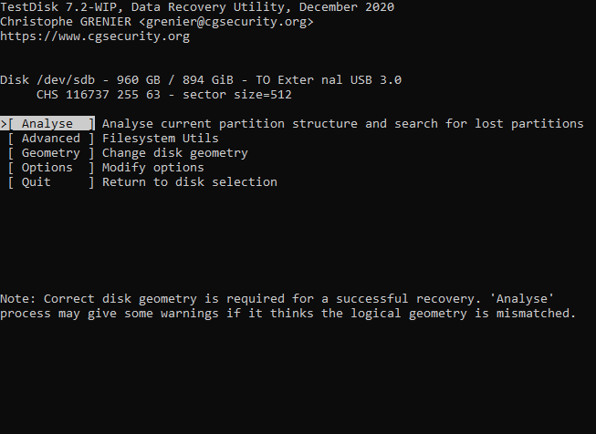

To further elaborate, please see the following screenshots. They are in sequence order 1-5
Sorry if I've missed something obvious. Thank you.

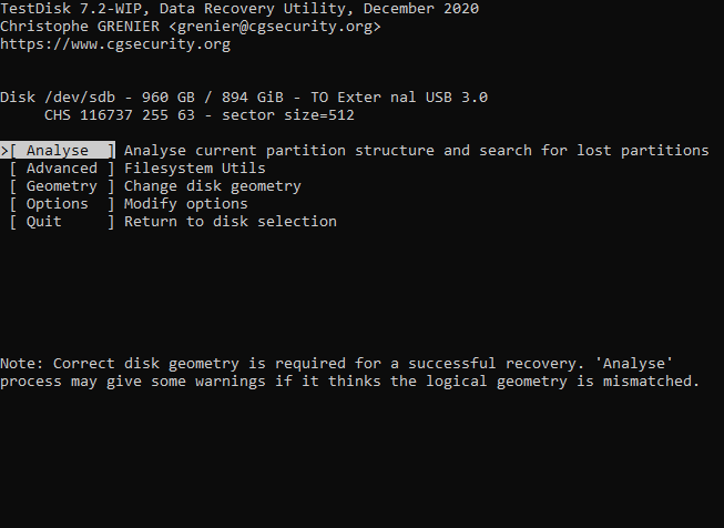

...continued.
Thank you

barndancer wrote: 02 Mar 2022, 12:30 I want to make this a bootable drive again, but I've read that these are seen a logical drives and they need to be Primary??
"but I've read that these are seen a logical drives" Where did you read that?
Look at the last screen!
