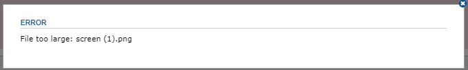

Hello!
Hardware is ok
Please refer to screen shot
As you can see OS can view this drives, but TestDisk can not
Your screenshot is unreadible. What matters, the Testdisk window, is just a part of the whole screenshot. There is a unreadible red note on the Testdisk screen. Why are you folks so inable to produce readible screenshots and upload them to this site so that they get kept forever in order to help others reading here? :roll:
Because:

As for the error message, there is free graphics software that allows to cut out the important things from a huge screenshot. ;)
