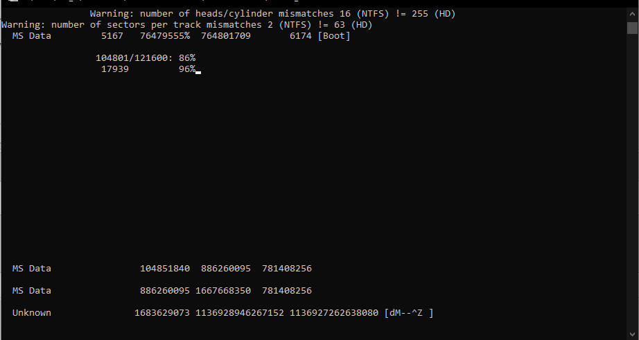

I have been running Testdisk for about 12 hours now. I understand it is a long process but I do not know what the messages mean. I have attached a screen shot of the current readout. Please let me know what other information i can provide to help try to recover my data.

I am not familiar with Testdisk, am stressing a little and would really appreciate any guidance. I resized the progress window and now my view of the current progress is limited. Could someone please advise if this is still OK or if I need to start over. I can scroll up to the original status information but it snaps back to the view shown here. And if I am still doing something wrong with respect to posting, could someone please advise me on how to improve that.

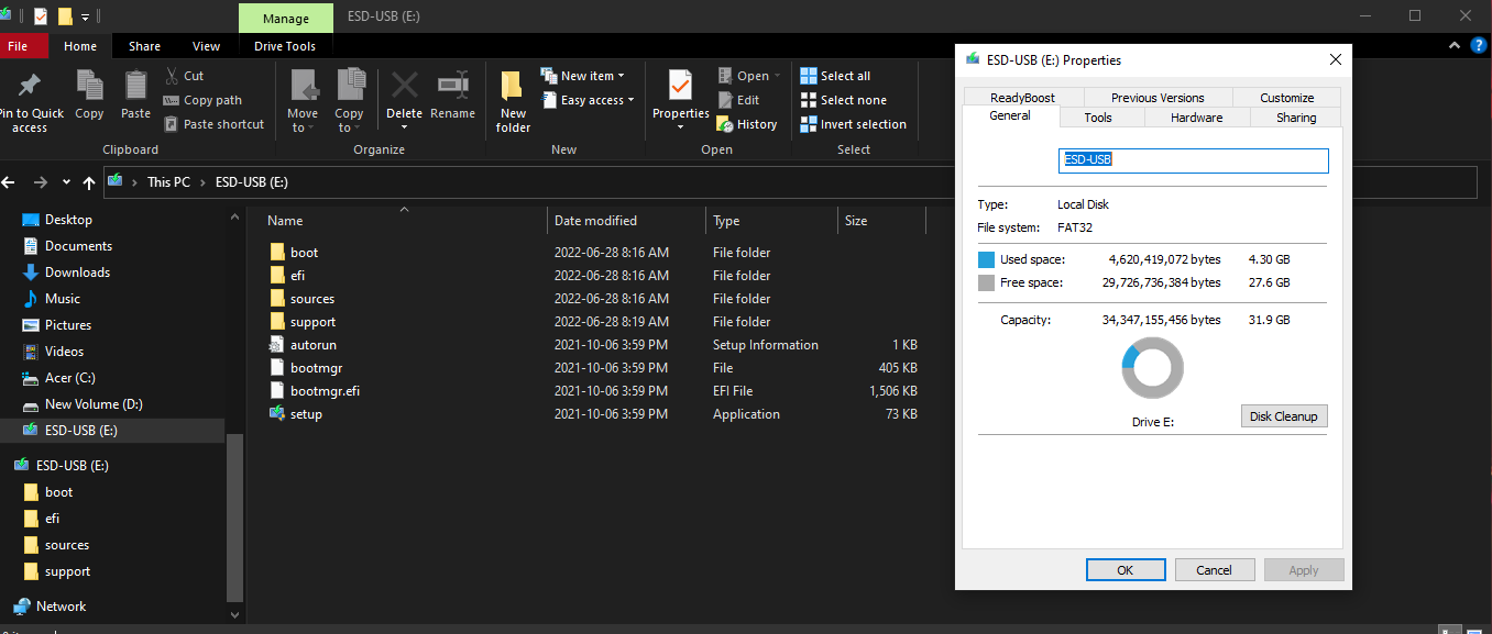

It is visible and shows the files for the Windows Media Creation Tool. As well, capacity reads as 31.9 GB, 4.3 GB used and 27.6 GB free. File system is now FAT32

I needed to make a media creation tool to try to repair my laptop. I usually use cds but my current computer does not have an optical drive. I found a USB stick but when i went to write the files i was careless and selected my USB external HDD by mistake. I did not realize my mistake until i removed the stick and tried to use it. Then i started sweating. Checked the HDD and the Media Creation Tool files where there. Looked online. EasyUS was suggested but it didn't seem to show any recoverable files. I was in a real panic so that could be a mistake I made (wrong drive selected...as it turns out, all 3 HDDs on this system are 1T and two are Toshiba so it is possible.) I did some more searching and found out about Testdisk and decided to give it a go. It has been running for about 24 hrs but i am not used to seeing results in DOS so not sure if it is working properly or if i need to do some preparation on the drive and start again. I can provide logs from Testdisk if that can be done while the program is running,

I have included a screenshot of the current status.

I did a run through (about 36 hours) with Testdisk. I have included the image of the result. Could this be because the Windows Media Creation tool formatted to FAT32 and the initial file structure was NTFS? I know there are instructions
to check HD jumper settings, BIOS detection... but not sure what to do next. I have also included tho only log file i could find. Not sure what to do nest and do not want to risk doing something wrong. Some of the data is irreplaceable so I am being extra cautious.
Thank you for any guidance you can give. I have read that some people (who probably know more than I do on this topic) were successful at recovering a large portion of the data lost when they did the same thing as I did with the media creation tool. I am still hopeful.

36h instead of 8h translates roughly into a transfer speed of 8 MByte/sec which appears to be to slow.
Your disk might be dammaged. For a quick check publish your smartmontools logfile:
viewtopic.php?f=5&t=10910
The location of the partition found starts roughly at the end of your disk and points to a sector location behind the last physically existing sector.
The data found is wrong.
Testdisk won't succeed when trying to run the p-key ("list files") on the next or one of the next screens.
The next step after running smartmontools and maybe ddrescue would be to run Photorec or any other recovery software.
