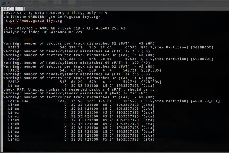

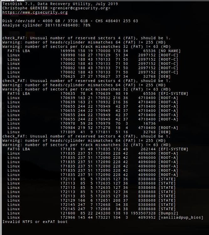

The progress overnight for Testdisk is shown as follows:
Then later this:

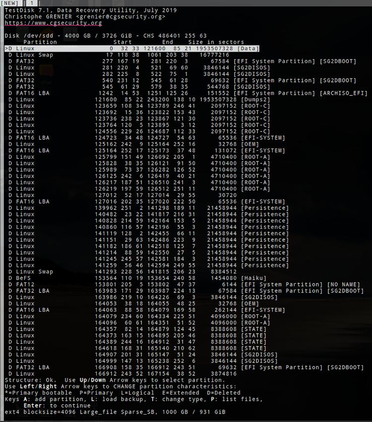

It completed: But I am lost to know what are the next steps to recovery of the drive with its original 4 partitions.
I am keeping the Testdisk screen open hoping for some recommendation of my next step(s).
Everything comes up "D". What does that prefix on each line mean?
Thanks in advance for ANY guidance

But could you or anyone suggest what I should do at the screen that I present. What is it telling me that could be done for data recovery/
I have read this section in the Testdisk manual: But I am at a lost as something in its language is foreign to me even though I am English speaking. It uses the word "let" on several occasions which is contributing to my lack of understanding the sentences meaning. I recognize that guessing wrongly could prove disastrous.
For example what does this mean???
...if you let them listed as deleted...
and what does this mean
..Let this partition...
I have not moved from the screen, shown above, as I am hoping for a suggestion to action such as go back and ??? or hit this key and ???
