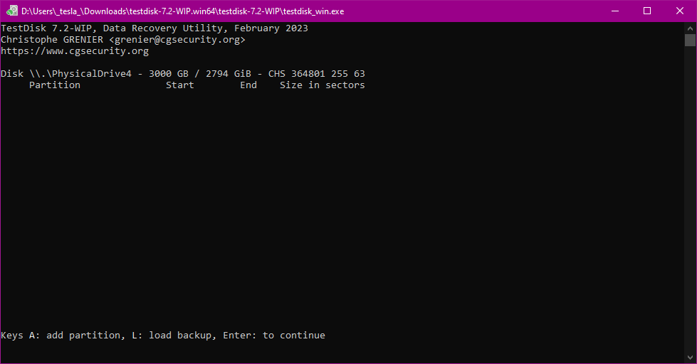

Hello...

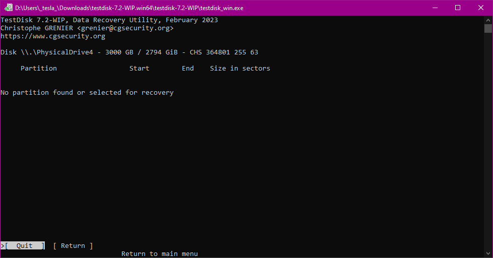

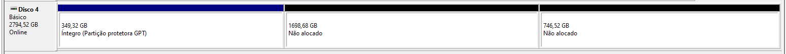

From the moment my cat ate the power cord of my external hard drive, I lost its partition, looking like this in Windows 10:
So, I lost the partition of my hd, where, although it shows me 2 partitions, I only had 1, in NTFS format...
Searching the internet, I found your tool and when running it, it showed me the following:
I completely disassembled the hard drive from the case and I'm using it connected directly to my pc's motherboard, despite the error shown, and is it possible to recover without losing my data? How should I do?
Anyway, press "A", I have the following information:
A big hug from Brazil...

Running tool again, I receive this information:
Suggestions?

tops wrote: 29 May 2023, 10:30 Hello...
Replace the cord or repair it and leave the disk in its original setting in the external enclosure.
As your disk is bigger than 2 TB there is a high chance that your enclosure contains some additional interface that is effectively changing the logical sector size at the interface.
Follow the steps outlined in
including quick search and deep search and post your Testdisk log file.

Hi Grenier,
Thanks for support, sorry for delay...

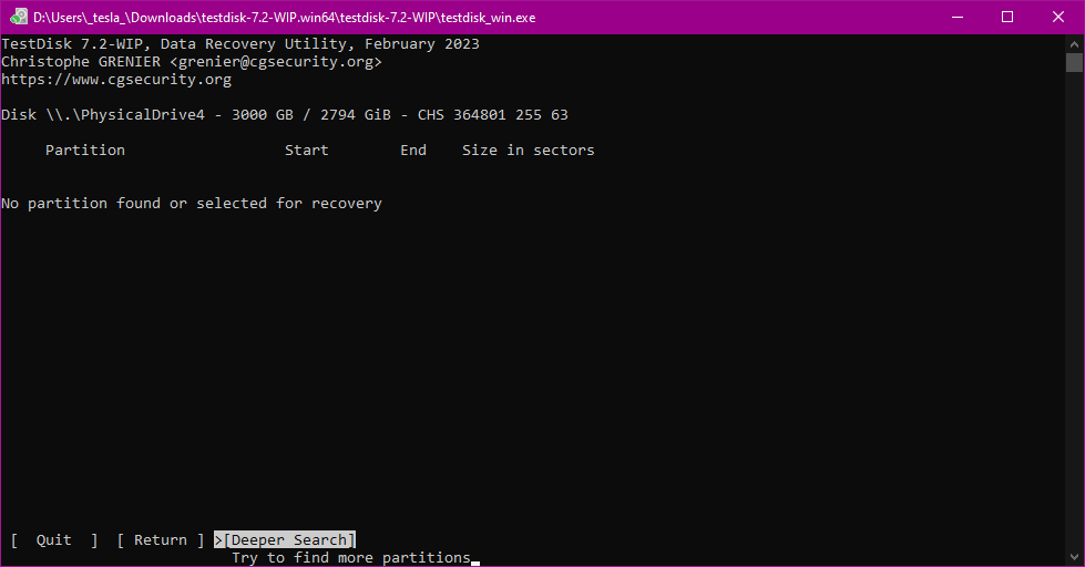

I redid the tests suggested by you and the results remain the same...
Follow the print and send the log below.. I initially did the quick search...
I will run deep search now...
My cat is just 2 months old ... as I have a desktop cabinet, he likes to stay on top because it's warm, but when I saw him, he already had the handle in his mouth, gnawing .. lol!
Log generate of quick search:
Wed May 31 02:40:51 2023

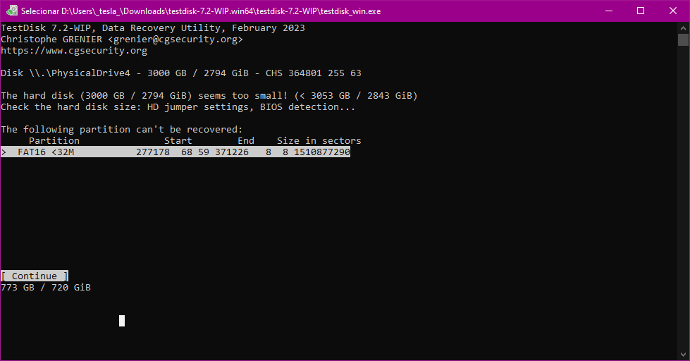

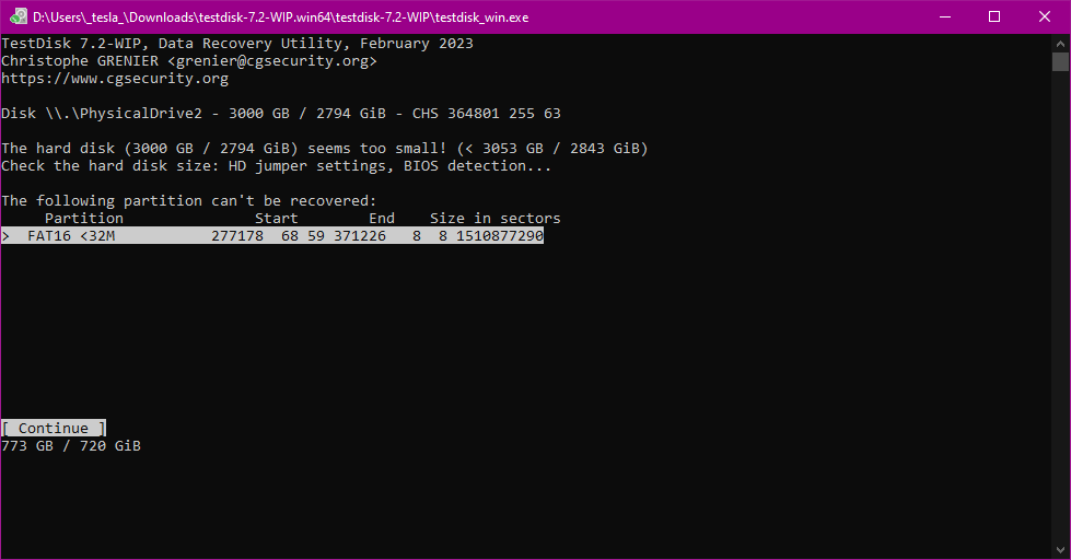

The deep search prints...
And the log of deep search...

Disk \\.\PhysicalDrive4 - 3000 GB / 2794 GiB - CHS 364801 255 63
The hard disk (3000 GB / 2794 GiB) seems too small! (< 3053 GB / 2843 GiB)
     FAT16 <32M           277178  68 59 371226   8  8 1510877290

file_win32_pread(564,16,buffer,2237837808(139298/245/4)) read err: read after end of file
file_win32_pread(564,16,buffer,2329466896(145002/155/2)) read err: read after end of file
file_win32_pread(564,1,buffer,2329466896(145002/155/2)) read err: read after end of file
file_win32_pread(564,16,buffer,2329467006(145002/156/49)) read err: read after end of file
file_win32_pread(564,1,buffer,2329467006(145002/156/49)) read err: read after end of file
Honestly, I'm desperate... :cry:
tops
Posts: 18
Joined: 29 May 2023, 01:33
Re: WD External Hard Drive Recovery Help
#9 Post by tops »
Running new tests...
I remounted my hard disk in your original case...
I could see that apparently my partition was changed to raw by the windows disk manager and testdisk is informing it as gpt in the log... :shock:
quicksearch is very slow - now we are running it via usb 3.0, even so, it is very slow, but I'm in no hurry, I'll wait until the end of the scan, because talking to a colleague who has already recovered data in this exact scenario, he told me said that the chances of finding the files are huge, but you need to be patient because on a 3 terabyte disk, it will take a few days to search for everything... :P :oops:
Fingers crossed, it will work! :P
When it's all over, I'll post the images and logs...
tops
Posts: 18
#10 Post by tops »
ALL FILES ARE RESCUE WITH SUCESS!!
I will buy a new Hard Disk to save my files!
