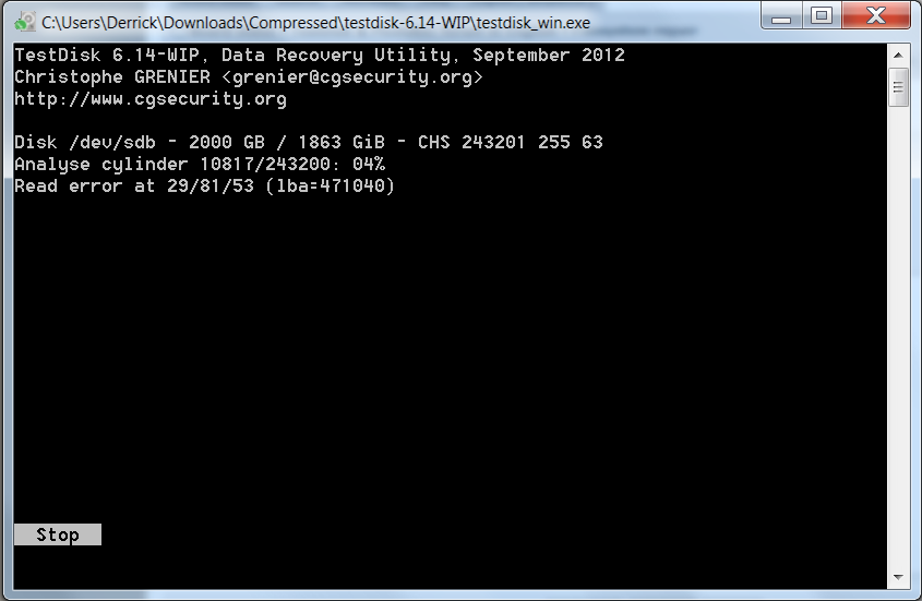

Please Help!...I've been run test disk at the analyse cylinder phase since 8 Sept (it is now 12 Sept) and it is only up to 4% (See Screen Shot Below). As I predicted, automatic updates for windows has installed important security updates on my computer and is now demanding a computer restart...how do I handle this since it is in the middle of this analyse? Am I going to have to start all over again? And I am still wondering about additional computer use and the connecting of my other hard drives as I mentioned above and how that might affect this process. Than you in advance for your assistance.

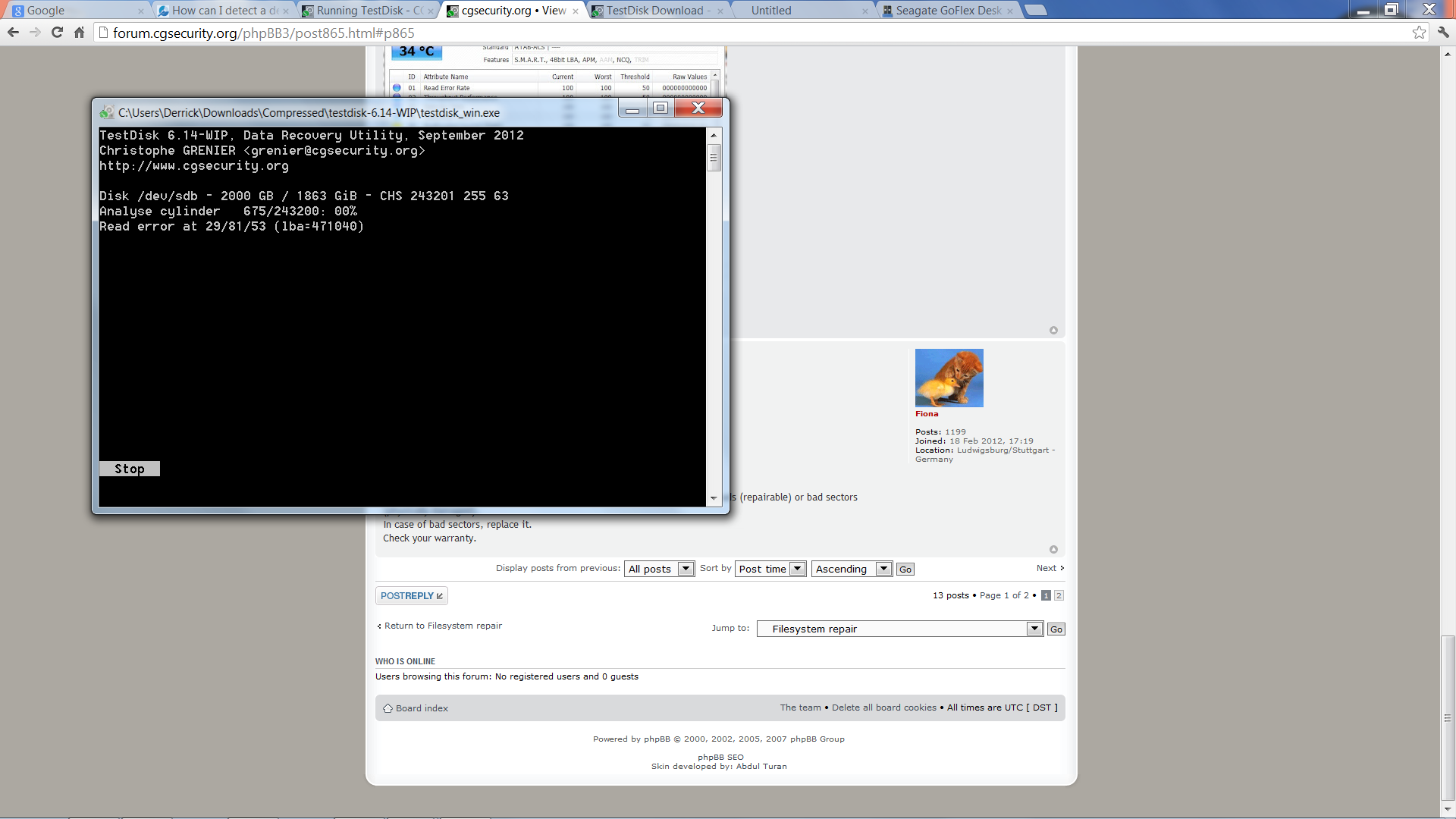

Re: Seagate 2tb GoFlex Desktop External HD
Here's The Screen Shot...
I've just joined this forum so I'm no expert. But I've been using testdisk with some success over the years and I've read your post.
I'm in a similar situation right now using testdisk 6.14-WIP to recover files from a failed SATA drive. I'm in dual boot mode with Windows Vista in one partition and linux ubuntu in other partitions.
I removed my faulty drive (containing Vista and ubuntu and various data only partitions) and I've placed this SATA drive in a SATA USB 2.0 enclosure. I've reinstalled Vista in a new drive and I'm running testdisk in windows (but I've also got ubuntu on a spare USB drive).
The advice from testdisk developer Christophe Grenier is to actually clone your failed drive so that you are trying to recover files from the clone .. as explained here.
But that would require you to start using Linux ubuntu for data recovery and this may be a step too
far. It could be useful at some stage to go through the exercise of
downloading ubuntu 12.4 desktop iso
burn onto a CD
install on a bootable USB (unetbootin can do this)
boot up into ubuntu
use linux file recovery to complement testdisk for file recovery.
Now a few points you raise.
The Windows update can be annoying in the middle of a (very long) recovery process. I found that myself in recent days after reinstalling Vista with hundreds of updates and some updates arrived requiring reboot as I was using testdisk and I'd left my laptop running for some hours. Annoying.
So I suggest that you disable auto windows updates before any recovery using testdisk.
Before running testdisk go to Control Panel > Windows Update > change settings
and set to "check for updates but let me choose whether to download and install them".
The next point you might explore is rather than going into "Analyse" .. which takes many hours ..
first try "Advanced" from this menu ...
Analyse
Advanced
Geometry
Options
MBR Code
Delete
Quit
next page
use up/down arrows to select select Windows (or other) partition
then right/left arrows to select "List"
then enter
The file structure of Windows (or other) will (with luck) be seen from List.
I found this out by reading some answers from Christophe Grenier.
Search the forum with keyword "advanced" to pick up some clues.
In short I've been needlessly applying "Analyse" and "Deep Search" (waiting hours for each run to complete) when I
found I could just go into "Advanced" to access my files within minutes and copy files to a target directory.
http://forum.cgsecurity.org/phpBB3/post5101.html#p5101
Another tip is to pre-prepare folders to receive the files copied by testdisk (although I believe that testdisk can select any drive or folder as target). In the testdisk installation folder I added a new folder /file_recovery and in that various folders to reflect the file structure in different partitions. Otherwise you'll find that your copied files are all mixed up in the testdisk root. You'll be prompted by testdisk to point to the directory to receive recovered files.
I hope this helps. I've just recovered all of my Vista files and I'm moving on to recover other partitions.
and look up the data recovery tips in ubuntu forum.

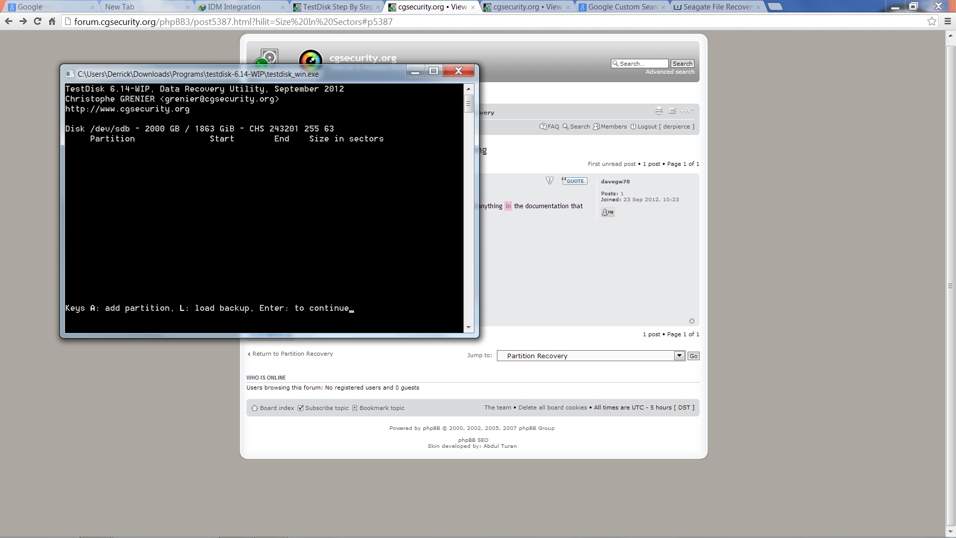

I tried to run advanced and it would not let me so i began running testdisk again. I get to the following window and can't find any documentation that tells me where to go from here to try to recover files. What should I do?
- testdisk - what next.jpg (240.75 KiB) Viewed 13006 times
The advise to read and follow the instructions in this page:
is good advise. Follow it. Clone your damaged disk and then you can run either TestDisk or PhotoRec on the clone.
The Knoppix CD is good for the task. Parted Magic could be another option (it carries a good selection of tools).
Ubuntu does not give you inmediate access to the Shell (Terminal) and you need that to start to follow the instructions.
It can however, use the same method for updating and installing software as Knoppix: apt-get
You can issue the command:
sudo -s apt-update
to sync with the relevant servers (connect direct to the router and the PC, with a cable).
and the command:
sudo -s apt-get install gddrescue
to install (without compiling) the GNU ddrescue required programme.
It will then be ready to be executed, just by typing its name.
You can test this by typing: sudo -s drescue -help
at the user terminal (shell).
Using disk recovery software and staying connected to the internet does not seem to be a good idea.
Best of luck
