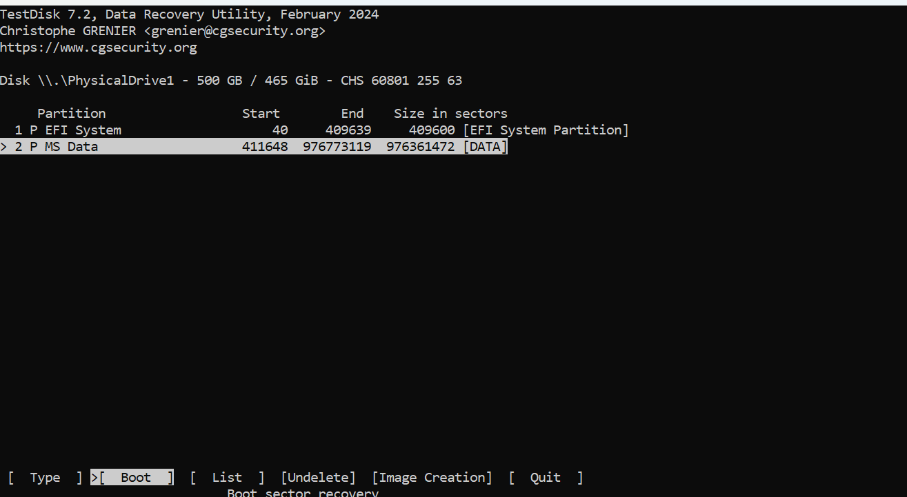

When operating testdisk on the physical disk, choosing the advanced option, I get the following screen:
Screenshot 2024-07-14 193712.png (33.14 KiB) Viewed 143665 times

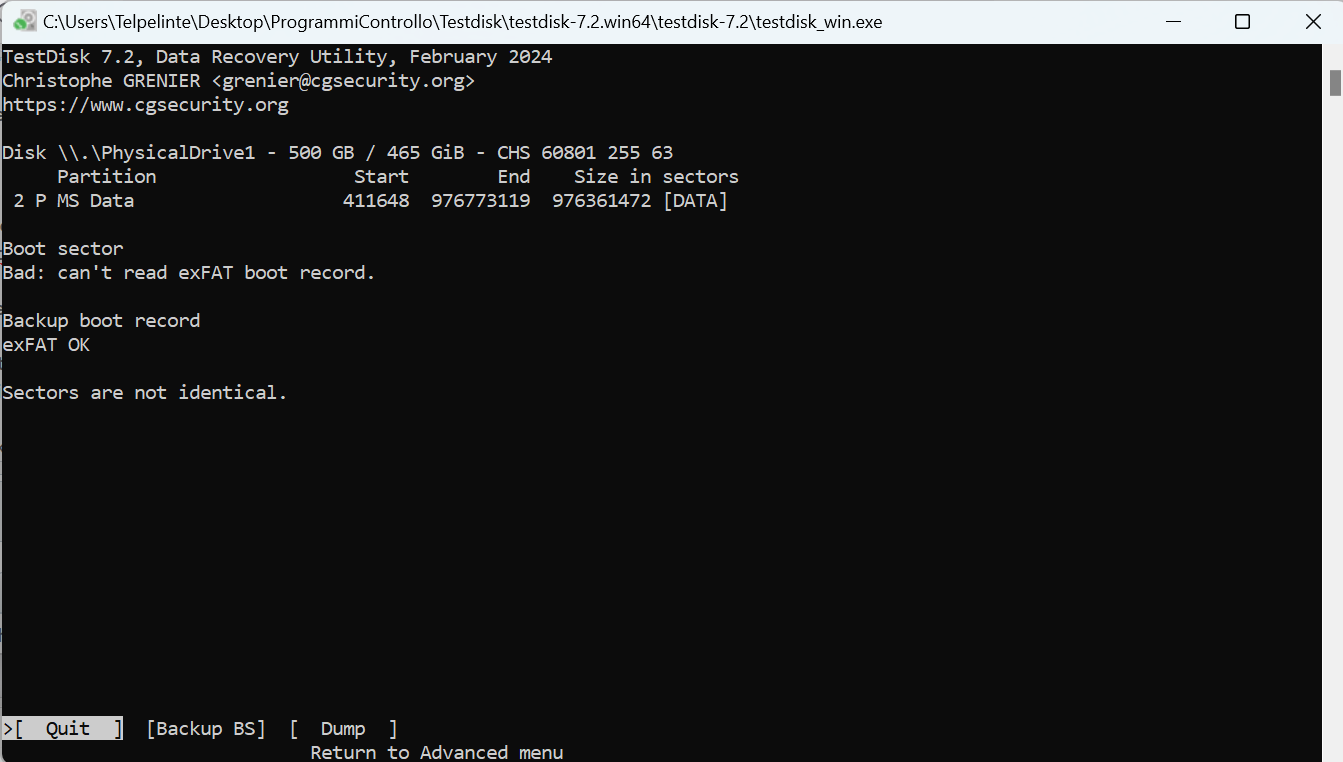

and, selecting the [Boot] option,
Screenshot 2024-07-15 204319.png (51.22 KiB) Viewed 143665 times

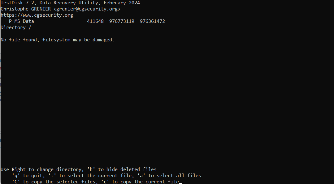

while, when performing the same operation on an dd image of the whole disk, mounted as a physical external disk using OSFmount, I get
Screenshot 2024-07-15 202644.png (53.74 KiB) Viewed 143665 times

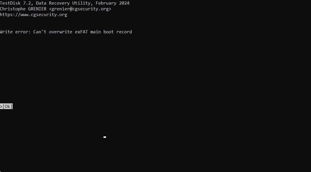

I can see the [Boot] option only when mounting the two partitions in the disk as separate virtual disks, but in this case the EFI partition is not recognized and I cannot operate on the image by using BackupBS, since I get the following error
Write error: can't overwrite exFAT main boot record

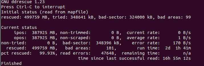

The size of the image I created using ddrescue is correct; I created it repeating the command many times. The output screen at last passage is the following
Schermata del 2024-07-16 03-29-51.png (46.57 KiB) Viewed 143618 times
I stopped, since bad sectors and bad areas were the same at the last two passage.

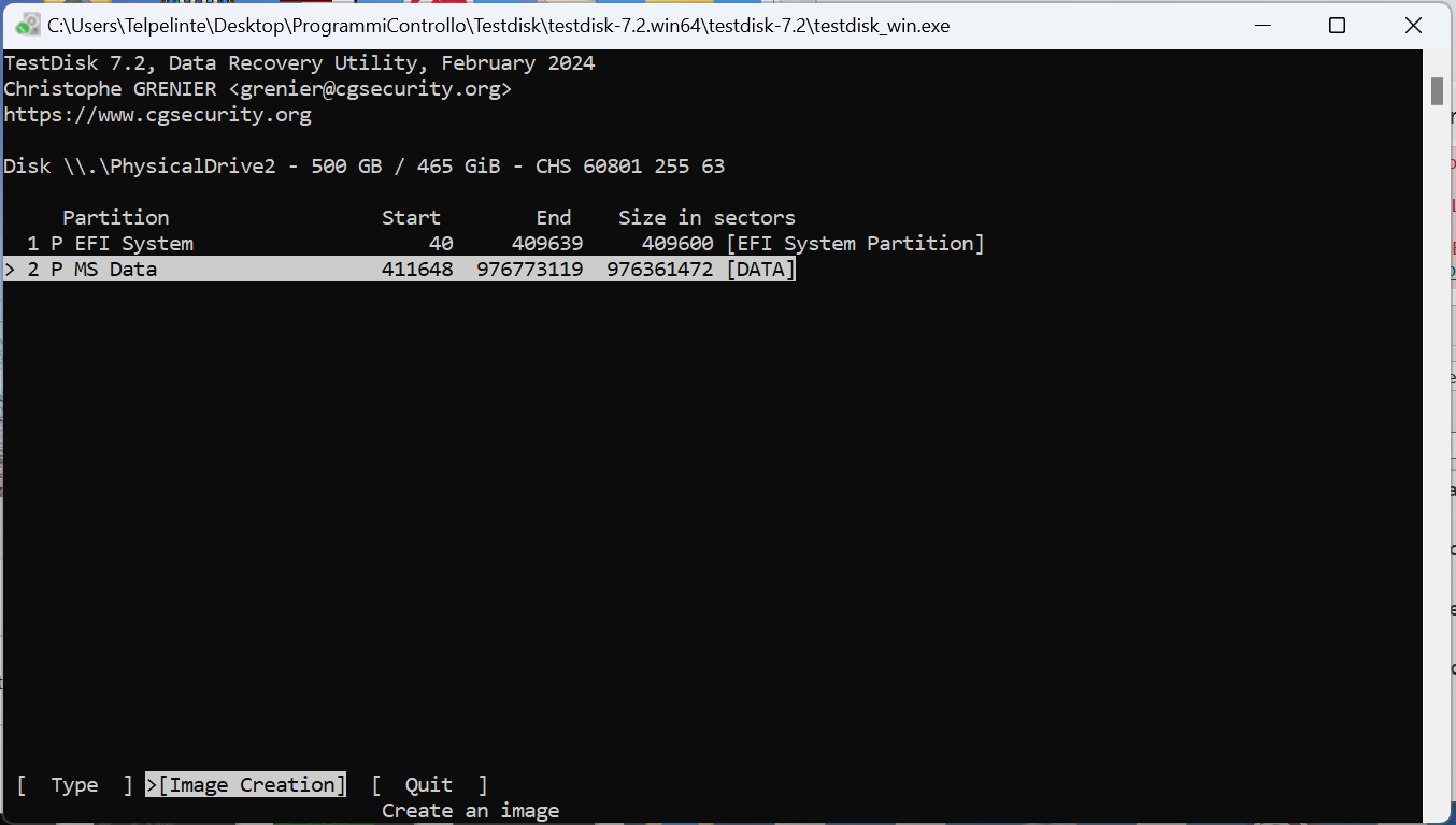

By applying testdisk directly on the whole disk image (working under linux), I get again
Schermata del 2024-07-16 03-50-28.png (40.19 KiB) Viewed 143618 times

Finally, I tried to operate on the physical disk.
I tried BackupBS.
This is the screen I get when analysing the boot sector
Screenshot 2024-12-16 182359.png (22.95 KiB) Viewed 133895 times
and this is what I get after choosing to copy the backup boot record
Screenshot 2024-12-16 182432.png (13.12 KiB) Viewed 133895 times
Is there something I could do to recover the disk?
I have also to say that, when operating on the image of the same disk, I can see files in the directory MS Data while I cannot on the physical drive, and I get this screen
Screenshot 2024-12-16 182218.png (22.63 KiB) Viewed 133895 times
I thank you very much.
Posts: 3190
Re: [Boot] is present when operating testdisk on Physical Disk, while it is not when operating on Disk .dd image
#9 Post by recuperation »
aleph wrote: 16 Dec 2024, 18:34 Finally, I tried to operate on the physical disk.
I tried BackupBS.
I don't know. Your log file does not mention the manufacturer and the model of your 500 GB.
I guess it is a HDD, in case of being a SSD the SSD can be broken but allowing read operations.
There is no directory. "MS Data" is a partitioned that should contain a Microsoft type file system.
If you can see files in there, the easiest way to rescue is to mark them and copy them to another healthy location.
Yes, it is a HDD, labelled as ASMT 2115. The manifacturer is HGST.
Yes, I shall do this.
But the owner of the HDD (my nephew) would like me to try to recover the HDD. Of course, if this is not possible there are no ways, but if somehow it is... :-)
