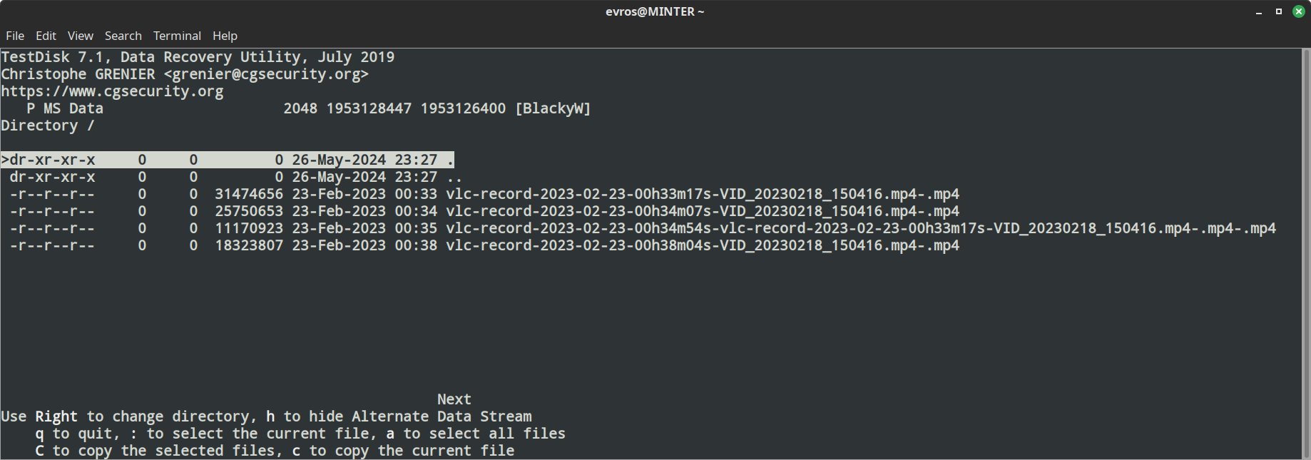

I'be already had a run with Testdisk, a simple "next" process with quick search, then with deeper search (took forever!). All that it found were the 2 recently built partitions, with the files I've put in them. Then I Photorecced, and wow! LOTS of files found (and copied to another external drive). As expected, files are named in numbers (except for a few, mostly software component I guess, like graphics, audios and .xml or .html that may come from the flash games). "Funny" thing, some movies got chopped into small chunks, and maybe some audio got separated from videos. I got about 15 "recup_dir.N" folders, 500 to 700 files in each, so you can guess I would very much prefer if it was possible to restore the original directories...
Maybe I should have "restored file system"? or "change type"? or... maybe I needed o mount the drive first?? Or it's simply hopeless. But how can Photorec find so much and Testdisk so *nothing*?
By the way, PhotoRec and TestDisk were able to access the external drives on the go, what's lucky because I never managed to run "sudo testdisk-6.13/testdisk_static" (command not found).
Hereunder are screenshots from the process. (they come from: Mint's Disks utility, Photorec and Testdisk, of which "contents" are the files I've put in for testing purposes) The first one, in this very message, is TestDisk devices choice menu, firts step I took.I'm also adding the text from the log file.
The source (formatted) SSD is /sdd while /sdc is the other drive I've told PhotoRec to restore files to. The "MS partitions" found by TestDisk are the ones I made after my box formatted the whole thing.

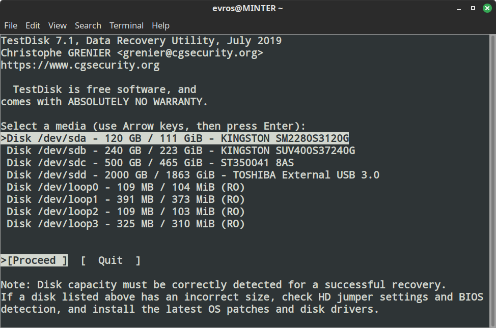

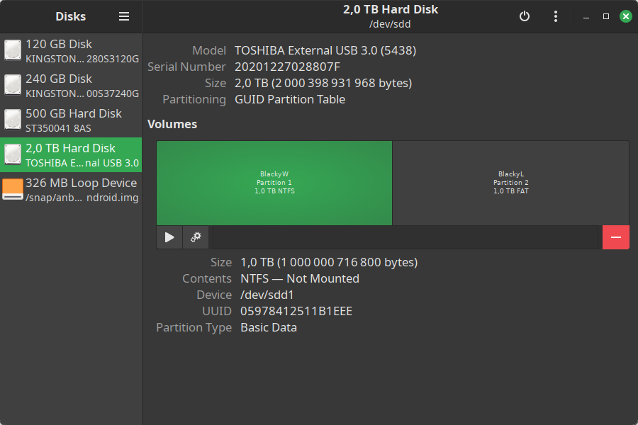

Here are the first 3 attachments: Log file, Mint's Disks window displaying the faulty ssd drive (unmounted), and TestDisk first partitions detection. (more to follow)
Testdisk partition detect 2024-09-14 23-02-22.png (108.97 KiB) Viewed 51403 times
Linux disk table 2024-09-14 23-01-40.png (87.53 KiB) Viewed 51403 times
testdisk.log
(7.87 KiB) Downloaded 1590 times

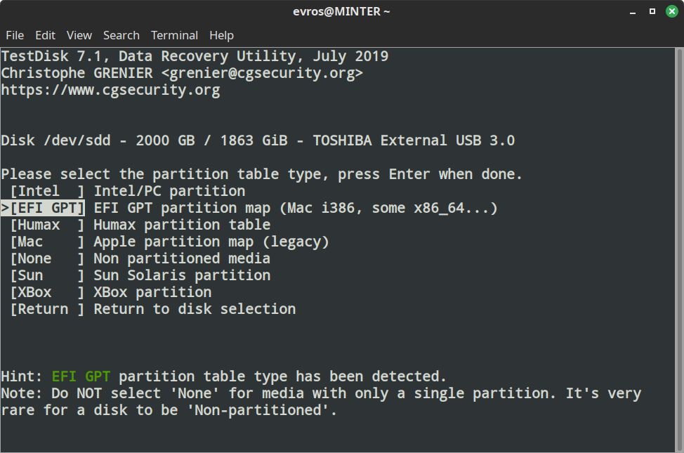

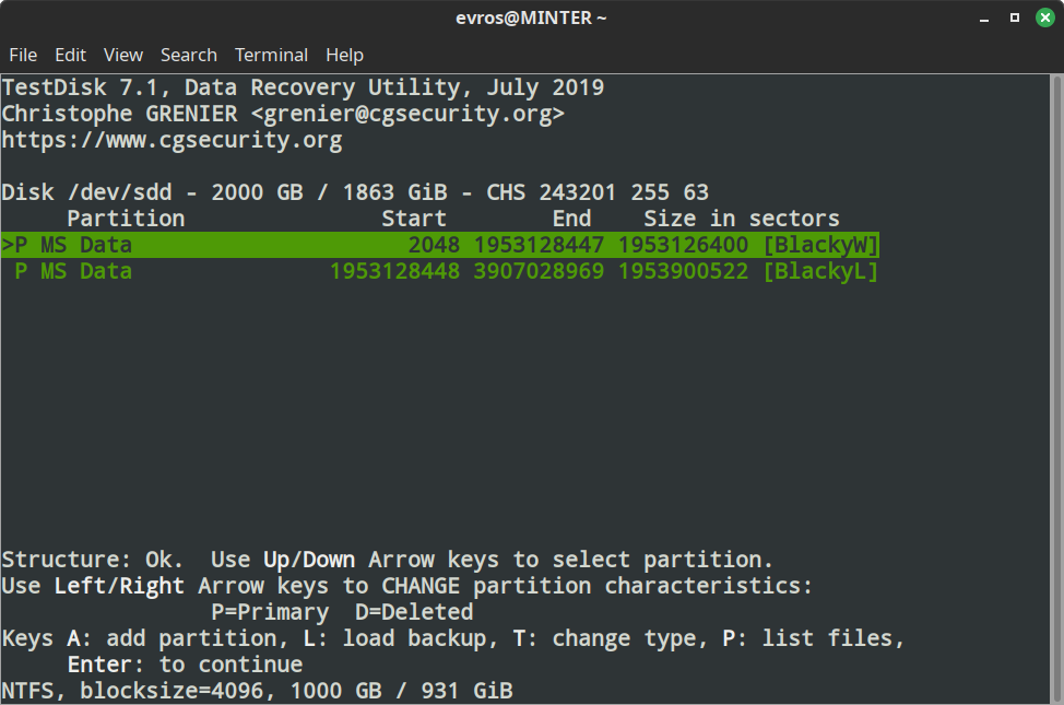

Following stages of TestDisk process: Partition choice menu, Quick Search stage, and results of said quick search. (next I'll post screenshots of PhotoRec use)
Testdisk contents 2024-09-14 23-08-13.png (121.68 KiB) Viewed 51403 times
Testdisk quick search 2024-09-14 23-04-52.png (102.59 KiB) Viewed 51403 times
Testdisk partition choice 2024-09-14 23-03-30.png (80.34 KiB) Viewed 51403 times

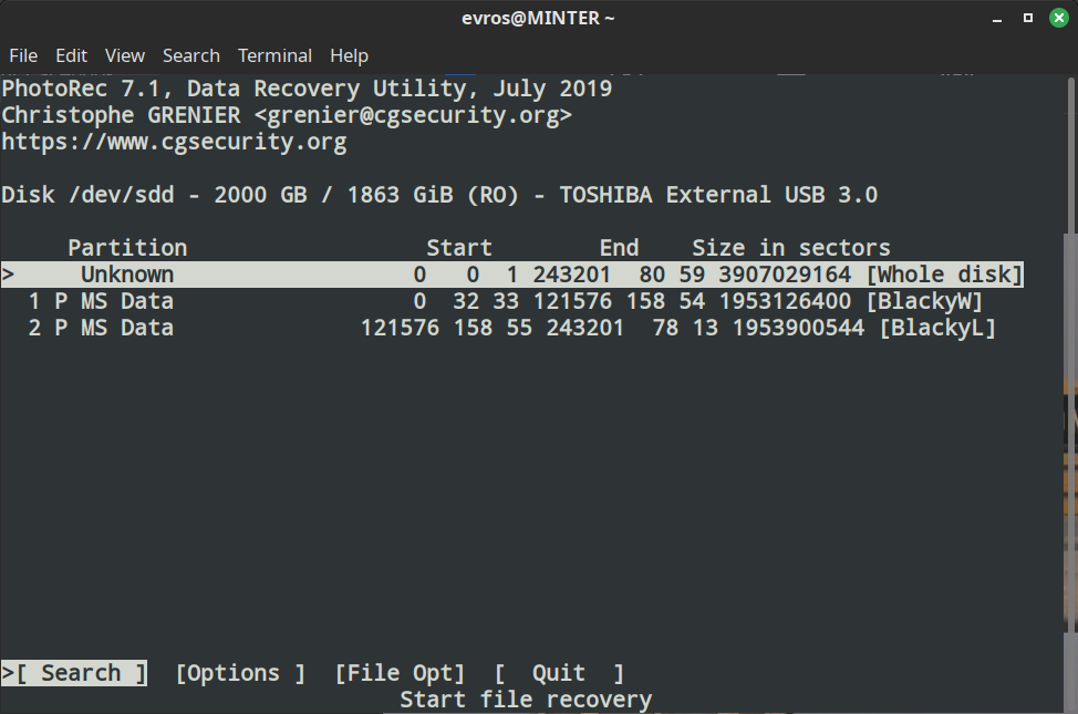

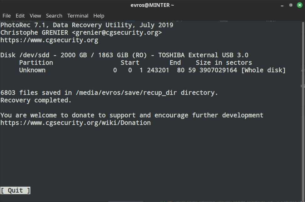

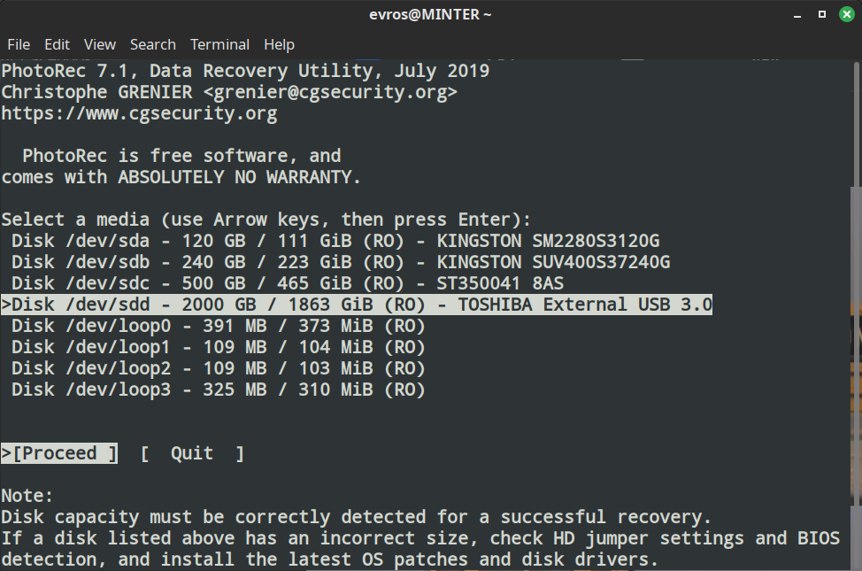

PhotoRec process screenshots (sorry, I see thet I can't really chose the order in which the attachments are displayed in my posts, but hopefully the file naming and the screenshots themselves are enough to understand what is what)
Photorec disks 2024-09-14 12-46-22.png (157.78 KiB) Viewed 51403 times
Photorec choice 2024-09-14 12-45-33.png (90.78 KiB) Viewed 51403 times
Photorec 2024-09-14 12-44-19.png (85.92 KiB) Viewed 51403 times

You are using an outdated version of the TestDisk package. Use version 7.2 or 7.2-WIP. Please refer to current documentation and try to be more specific in asking your question.

Although you are mentioning "TestDisk step by step" you probably have not read

When running TestDisk, try TestDisk, Advanced, select the "BackyL" partition, List. If you see your files (with a non-empty size), you should be able to copy them.
You can also try "Scrounge NTFS" to recover files from your NTFS partition but it doesn't always work after reformating, so PhotoRec may remain the "best" solution.
You will recover more files when using PhotoRec on each partition (the first partition, next the second one) instead of the whole disk (ext4 uses indirect blocks, double indirect blocks that need to be handled)
