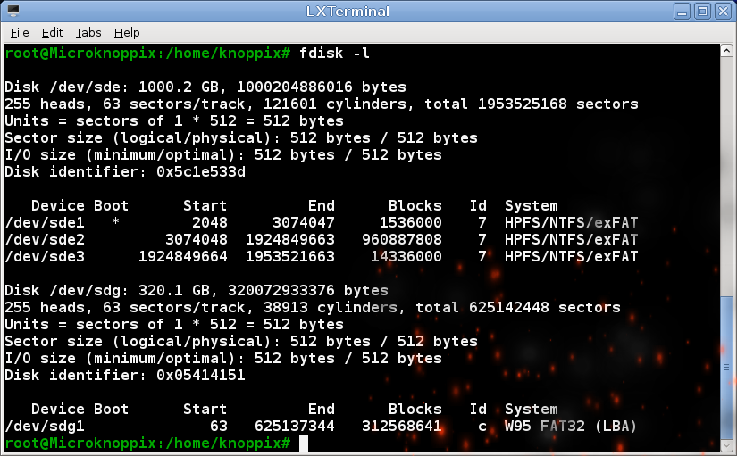

Thanks for this, I have managed to boot Knoppix 7, but I am just trying to make the clone now and seem to have hit another issue. I have included a screen print of the "fdisk -l" that I ran from the console, but it is not showing the device I need to copy, the device listed as /dev/sdg1 is where I intend to clone to.
Does anyone have any idea why this device is not showing?

#8 Post by cgrenier »
If you run "testdisk -l" or "lsusb", do you see your memory stick ?
