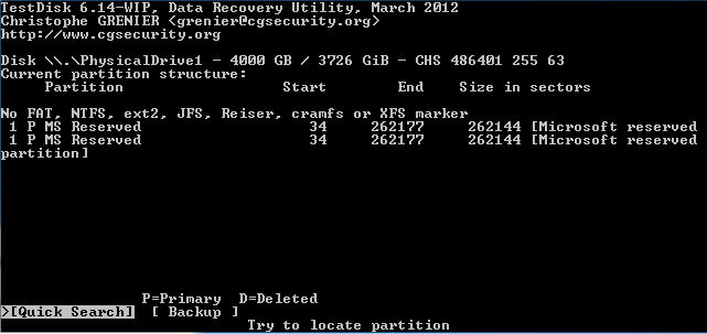

I have 2 - 2tb drives with 1 partition of 4000gb/3726gb with a NTFS file format. The screenshot below is after I ran analyze and chose the EFI GPT partition type. I don't know what those MS Reserved partitions are, but it's missing the partition I'm looking for with a name of "Data".

Re: Successful but RAID0 is still RAW in Windows

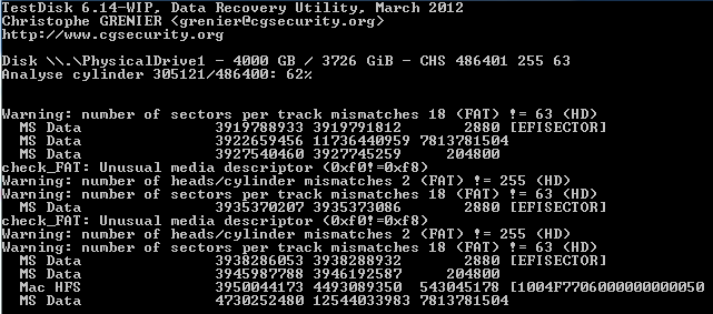

After 4 hours, here are the results (so far) of the quick search under EFI GPT:

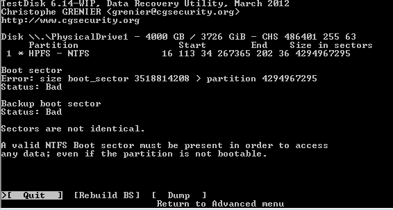

There is a RebuildBS option if I Analyze the disk as Intel and go into Advanced->Boot. I do find it odd that the partition is found as a type of Intel and I can list the files this way. EFI GPT isn't getting very far. :(

If you choose Intel and TestDisk find a partition and you can list your data, would you copy/backup your data first?
Intel MBR supports Disks up to 2 TB (max 2.2 TB).
If you create larger partitions and you're using Intel, might cause loss of data.
That's why we tried to use EFI GPT and repair or rebuild your boot sector.
But if your disk appears on EFI GPT as unallocated, there will be no partition to diagnose your boot sector.
Might be a possibility to create a partition on EFIT GPT (same start, size and type as before) and have a boot sector diagnose.
If you have a backup, you would be able to copy your data back.
Please let me know.
