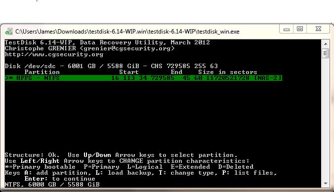

I have 4x2TB HDDs in a RAID5 format. I have already gone through the steps to recover the partition. I have even listed the files to make sure they are still there. I get to the step shown, hit enter, but for some reason it doesn't recreate the partition. Instead it created a single NTFS partition of 2TB and an unallocated space of 3.45TB. What am I doing wrong? Please help.
- Capture.JPG (55.24 KiB) Viewed 8518 times

Please have a look in your disk management console.
On the left side, check your disk, is it a basic disk?
Basic disks only supports up to 2 TB.
Bigger disks must be GPT.
If you use a basic disk bigger than 2.2 TB can cause loss of data!

The Disk is listed as basic. Should I convert to GPT? Then will it work?
Re: RAID5 Partition Recovery
To support Disks bigger than 2.2 TB you should use GPT.
Your RAID 5 is treated as 1 disk.
So it might be advisable to use it as GPT.
Currently I've no idea what about your data?
Then convert it to GPT.
Windows 7 can increase your partition.
But I've no idea about your OS?
If you use Win7 just right click your partition in your disk management console and increase your volume.
You also can create more partitions.
Just as you like it!
You should backup your data first.I have even listed the files to make sure they are still there.
