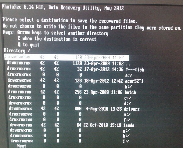

I have exactly the same problem. Destination drive is FAT32 formatted i cannot select it, there are mixed drive letters and root files in the list of destination drives but none of the letters is my drive.
I tested versions 6.13 and 6.14-WIP, both the same problem.
Version 6.08 works fine.
- image.jpg (80.2 KiB) Viewed 18491 times
