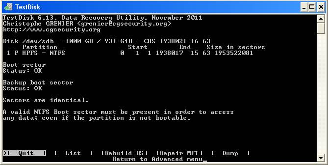

I have a problem with a hard disk hitachi 1TB (Model HDT 721010SLA360 - CHS: 16383/16/63 - LBA: 1953525168).
The disc has a single NTFS partition that contains only data and no operating system.
The hard drive, connected to a PCI controller is properly recognized by the BIOS and also by TestDisk, but the disk geometry is wrong.
Inserting the correct parameters TestDisk assigns a different dimension of the disc (8455 MB), much lower than the correct one.
If I proceed with the geometry found by TestDisk detects an error in the number of heads: 16 instead of 32.
If I ask the list of files TestDisk detects only two folders that contain a few gigabytes.
I believe this is due to incorrect geometry detected. What do you think?
How do I insert the correct disk geometry?
Thanks.

Hi Fiona,
here are the Testdisk screenshots:
16 heads
Quick Search(16).png (27.7 KiB) Viewed 19936 times

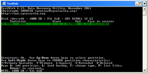

#5 Post by kaxyus »
32 heads
32 heads
thanks for your help

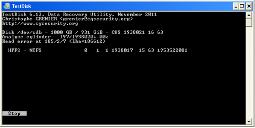

#6 Post by Fiona »
I assume that folders are lacking?
As far as I've seen, you've got a couple of read errors.
http://forum.cgsecurity.org/phpBB3/down ... php?id=189
http://forum.cgsecurity.org/phpBB3/down ... php?id=190
It could indicate a damaged file system.
You should stress your harddisk as little as possible.

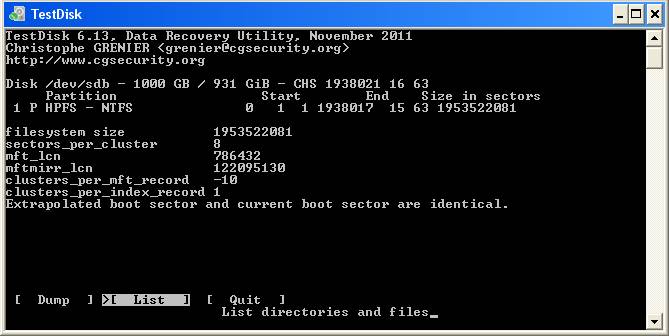

Hello Fiona,
here the screenshots related to the Boot and Rebuild BS command.
Rebuild BS was very quick, few seconds. The List menu appeared, but the result has not changed: the root folder appears, but inside there are only two folders, not all of those originally present.
Re: Wrong Geometry
#10 Post by Fiona »
There is no change.
Looks like your file system is damaged.
In your case datarecovery software mit be necessary.
You can use PhotRec or commercial software if you want to try it first (demo).
PhotoRec doesn't keep file names and directories.
