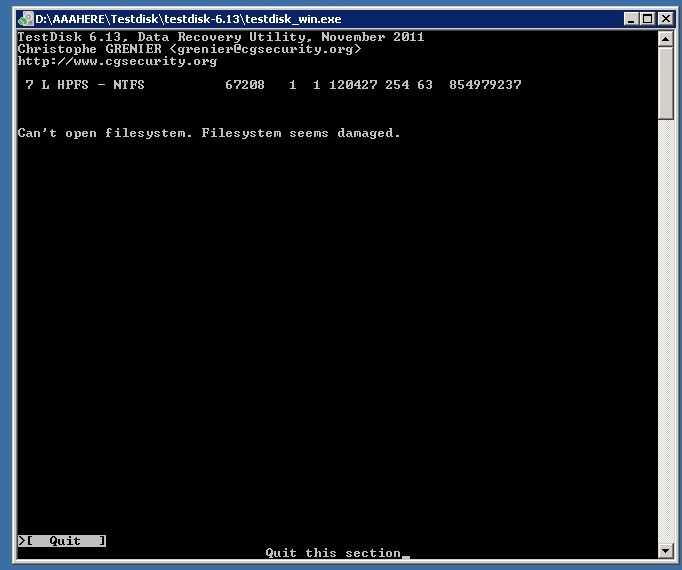

Not sure if the log file attached - here is the screen print of selecting Undelete in Advanced menu option
- Testdisk.jpg (53.09 KiB) Viewed 7312 times
Re: I stupidly formatted my NTFS partition to FAT
In Advanced, try RepairMFT. If it doesn't work, try other recovery utility. You can always use PhotoRec to recover your data but recovered files won't have their original filenames.

Thanks for your reply.
I ran Testdisk again and selected the Advanced option. Unfortunately I do not get the option RepairMFT. Is this the end of my options for recovery of the formatted partition? I already tried three different Recovery tools (Windows-based) and they were no use.
I have tried PhotoRec (it is easy to use) and it it is finding many jpeg files but a lot of them are only a few KB and they seem to form complete pictures but of greatly reduced number of pixels. Those files which are of a large size (close to the original) appear to be complete and retain the original date, although no other information. Having the original date of the photo would make sorting them easier.
- Testdisk Advanced 2.jpg (80.49 KiB) Viewed 7284 times
