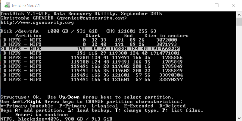

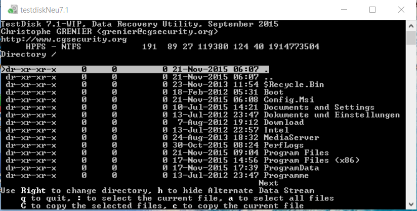

Re: Q to quit doesent go back to Deeper Search results?
Posted: 21 Nov 2015, 16:43
@ sebastiank
But when I enter in a particion (pressing "p") that can't be recovered
Partition which can't be recovered is a message only!
Reason is often, that a partition ends after disk limit.
So there is no possibility to list any files.
Only on results, you can select a partition and press p to list your files.
In some cases, I've had a trick to make partitions which ends after disk limit available.
Can you upload a snapshot with your message?
So I'd be able to judge, would it be worth to increase the values to make it available or not?
@ jco1971136
I've downloaded the latest version and tested it.
But it wasn't possible to recreate your problem?
Example:
After pressing q für quit, TestDisk jumped back to the result of Deeper Search:
I have tried Q and Esc., both go back to
"Analyze".
Did you try it on capital letters like Q?
Can you try to use q only?
