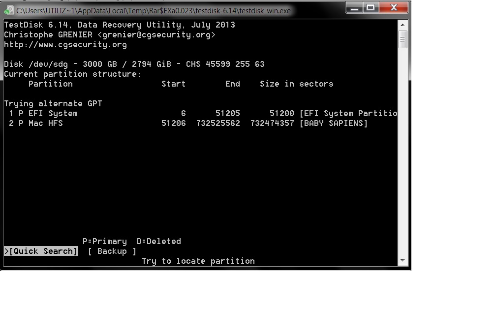

I'm leaving it analysing through the night. Here's an image of what it's detected.
HFS+ disappeared in WD Mybook 3Tb

TestDisk get its info from the OS.
Only the DOS - version gets the info from BIOS.
That's why its recommended to make a diagnose on an Intel-Mac.
You should avoid to use pdisk, because it's only supported by the old PowerPC, not Intel Mac.

I'm led to believe that the problem might haven't been that critical as I thought, but still many files were damaged, i think maybe 25% of the disk's files.
I have created an image disk with Testdisk to another 3TB drive (almost two days to make it), in the end it said it hadn't further disk space to continue the Image Disk file. I still took a try with OSFmount and voilá, i made it to the files on the damaged drive. Backed'em up and almost happy end of story.
Not convinced yet, I cycled through some more inputs about WD external drives, and I found some guy who had kind of similar problem, just couldn't mount the drive. Amazingly, just by using a s*** usb extension cable made him gain access to the drive. I tried it with the damaged drive and.... it mounted in Windows. Just did it on the first time I tried, since then it has never mounted again even with the extension. It was that only time that i managed to check the files and be sure they were really corrupted (thought it could be a problem with the disk image).
So it's kind of an end, learned a lot with this, specially avoiding WD external drives probably...
Still don't know if I handled the process correctly with Testdisk, but it kinda worked out! I did it only in Windows, do you think I might not get corrupted files if i make full proccess again on Mac with Testdisk? This Mac was good in his new days, but to run this 3TB process it would be a long painful waitl, as it still got me many days to work it out in my Windows, which is recent and reasonly powerful
