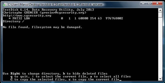

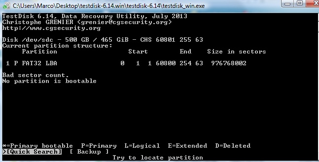

Dear all, I am new to this forum, and almost new to TestDisk also.
Therefore I beg for your patience, beside your help.
My 500 GB Packard Bell Go disk crashed. The disk was non-partitioned (I mean, no partitions created by me).
I am trying to recover the data it contained, but I come to the following result.
What should I do? Please... help!

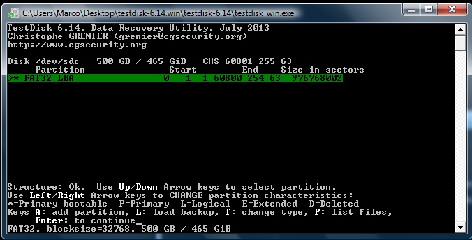

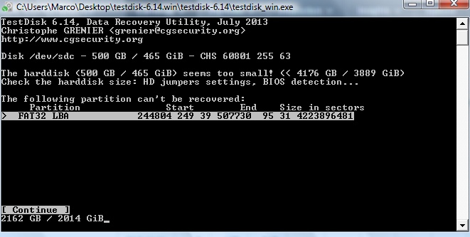

Dear cgrenier, thanks for you reply.
I don't know if it was FAT32 or NTFS. I just bought the disk and copied files inside... :?
Here are results after Deeper Search tool.
TestDiskDeeper Search.jpg (55.22 KiB) Viewed 29542 times
I forgot that the disk was damaged after falling to the floor.

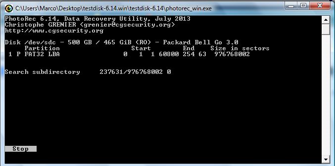

I tried it.
Subdirectories number grow quickly and then stops in a few seconds always to the same number. See picture. Then there's no way to do anything, I cannot even kill photorec process from ctrl+alt+canc window.

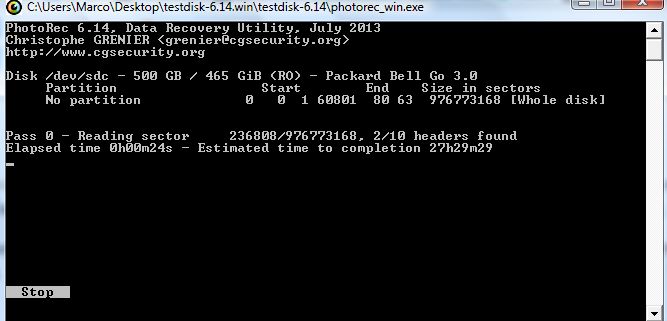

by Ulio
I was able to resume the previous session and I got stopped at this screenshot:
