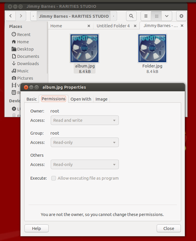

Thank-you very much for Testdisk supurb piece of work , I managed to recover everything off a USB Stick , Mostly my Jimmy Barnes rarities cd's , But now I cannot delete the other music that I don't need copies of . Access has being denied , the files on the USB are from my previous machine and I am now running Ubuntu 13.04 on a new machine with different login paswords etc etc . How can I ever get access to the other files ( I already found else-where ) to delete them as I don't need two copies of Faskil's Albums or any other album ,. Please can some-one please help me unlock these duplicate files ? ,I would like to delete the xtra files but not sure how to unlock them
- this is problem.png (109.83 KiB) Viewed 7868 times

Re: No access to files
Did you try some commands?
For example:
Or in case of a folder / directory:
For example:
sudo chmod 777 /location/to/files/music.mp3
sudo chmod -R 777 /location/to/files/music.mp3
Thanks for replying so quickly I did do some commands and got the files back into my system ,that was good , now those files are in the home folder and still will not move , copy ,cut , rubbish bin or delete to any where because " it " says I am not the owner ,ok I can handle that the files were from my other machine that has totally expired ,ok ,Do you know of a way to change ownership in terminal of those old files ? Or is it a dead end ? Please excuse the puns but I do have stop me ripping out my hair . Also most of the recovery was done just on the pre sets setting on the programe menu , nothing fancy or silly added to Testdisk just ran with it the way it was , is , I still think it's a great program and the problems I'm having is more from me , than Testdisk ,it did fine ,just so frustrating to find some hard to get rare music and not be able to access it , OK OK I should stop typing and let someone answer , Do you know of a way to change ownership in terminal of those old files ? Thanks in advance to anyone who has an answer .
If I'm not mistaken then you could try this:
If you want or need to know more about the chown command then you can use:
Press q on the keyboard to quit and exit the manual.
sudo chown -R <current_username> /location/to/where/directory/is/
man chown
OK will give that lot of commands a try and let yuo know how it goes ,thanks for the advice hope it goes good
Re: No access to files # SOLVED
Alrighty this is fixed , solved and answered , and a big Thank you to "theancientone " and so that's where I go to change ownership , very smart , it is all the commands I will need to fix this ,they come up , just have to work out all that " man chown " just have to put in the correctly , learning new computing stuff at my age heh , sadly it will not be in the next day or two , medical reason's it will get done that's for sure ,, Thank you and all the best .
