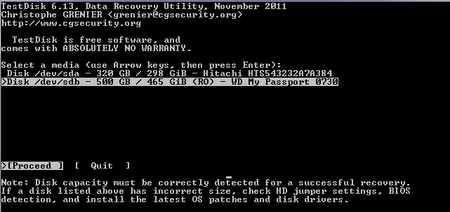

Thanks for your reply Fiona. TestDisk finally showed my external hard disk as in the attached screenshot. I have chosen the relevant disk but I think it's gonna take a while before I can use Analyse.
WD - testdisk 1.jpg (58.03 KiB) Viewed 12813 times

Re: WD My Passport 0703- Crashed, won'event show on TestDisk
#5 Post by Fiona »
RO means read only.
Probably depend on your MacBook.
But might be ok to have a diagnose!
