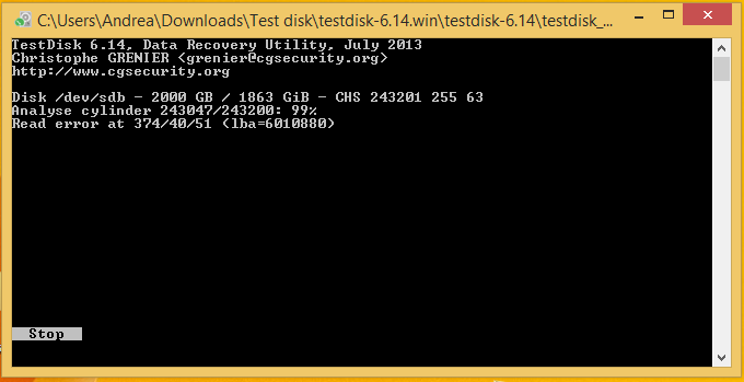

I've used TESTDISK --> Analyze --> Quick search (see pic1 in attachement). Quick searh actually lasted 1 day.
During quick search I received the message read error. What does it mean?
After quick search: NOTHING! It simply do not list any partition. (see pic2 in attachment)
Now my options are: A = Add a partition; L = Load backup; Enter: to continue.
What should I do? Thanks in advance.

- During Quick search
- Pic1.png (17.32 KiB) Viewed 3793 times

It looks like all read operations failed. There can be several possibilities:
- bad sectors, in this case, the best is to clone the disk to a new empty one using gnu ddrescue
- insuffisant rights, you aren't in the administrators group. You may also need to use Right-click "Run As Administrator"
- bad disk driver for Windows. Check the disk on another computer or boot your computer from a Linux LiveCD
http://www.cgsecurity.org/wiki/TestDisk_Livecd
