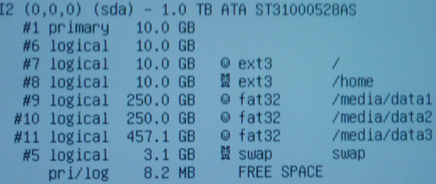

I found this image from the partition list when I was partitioning the disk some years ago. Not sure if it's the final partition list I wrote to disk but it's worth a try.
How can I use it to test it? I'd like to try that partition list and see if I can get the data as it was.

This screenshot doesn't match the partition table listed in testdisk.log
Do you see your files when you list the files from the 3rd partition ?
