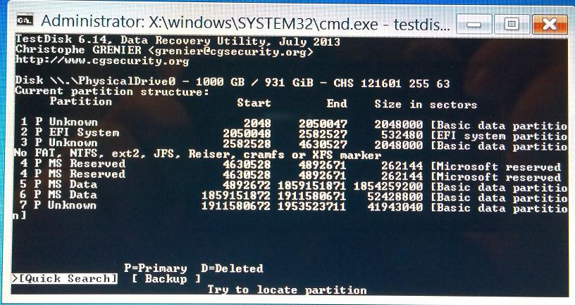

Below is my current partition structure:

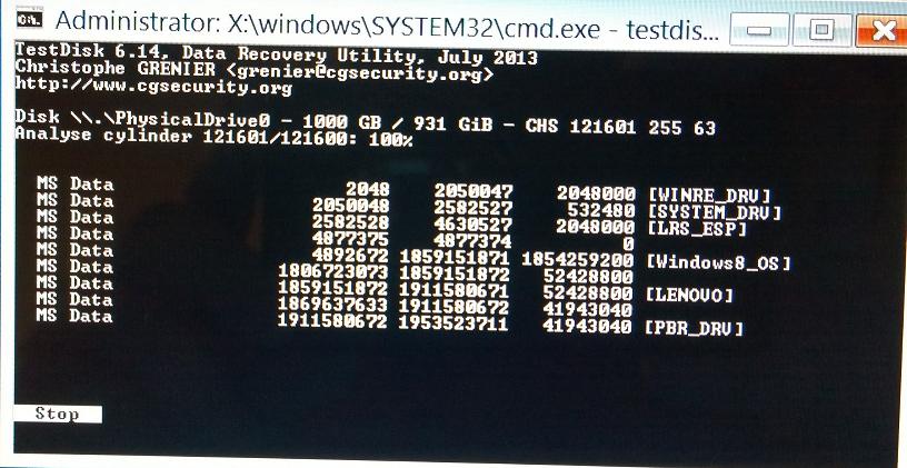

I tried running the Quick Search, but it hangs after hitting 100%. I think it is because of the partition that is showing 4877375 to 4877374, size 0:

Any help is greatly appreciated. I also ran testdisk with the /log and /debug commands. It took almost 48 hours to run and created a 10,000 line log file, but I can send that to someone if it is needed.

Thanks, cgrenier. I REALLY appreciate the help. I'm able to list my hard drive files when I choose a drive letter (C or D) as my media, but when I choose a disk (Drive0 or Drive1) it only shows me the files on my thumb drive (where I'm running testdisk). I'm running my cmd prompt from the boot manager on a Win 8.1 disk.
I've copied my log file below. I wasn't able to attach a *.log or *.txt file. So, I hope this is ok. Let me know if I didn't include enough information. Could the issue be with that 4th partition? It looks like there was an error there and I'm seeing two in the current partition structure.

4 P MS Reserved 4630528 4892671 262144 [Microsoft reserved partition]
1 P Unknown 2048 2050047 2048000 [Basic data partition]
2 P EFI System 2050048 2582527 532480 [EFI system partition]
3 P Unknown 2582528 4630527 2048000 [Basic data partition]
5 P MS Data 4892672 1859151871 1854259200 [Basic data partition] [Windows8_OS]
6 P MS Data 1859151872 1911580671 52428800 [Basic data partition] [LENOVO]
7 P Unknown 1911580672 1953523711 41943040 [Basic data partition]
Re: Novice seeking help...
#4 Post by cgrenier »
From a Windows cd/dvd (not a restore CD), try rescue mode and run 'fixboot c:"
