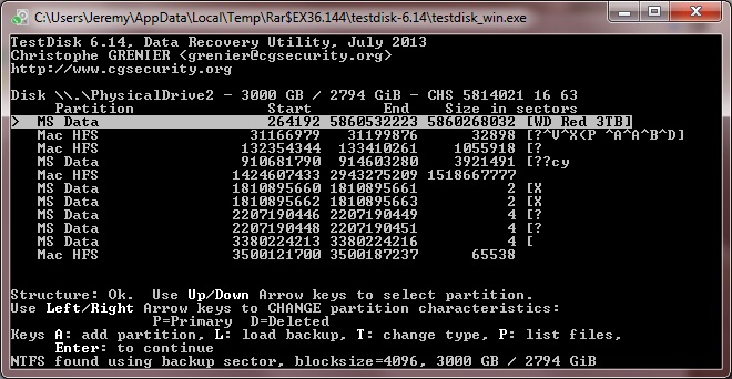

After Deeper Search, select "WD Red 3TB", press 'p'. If you can see your files, set this partition as P(rimary).
On next screen, choose Write, confirm, Quit and reboot

Run TestDisk, Analyse, Quick Search, choose Stop, use 'a' to manually add the partition "WD 3TB Red", the starting and ending sectors need to match the values from the screenshot, set this partition type as MS Data/NTFS. Set the partition as P(rimary), On next screen, choose Write, confirm. Go in Advanced, select this partition, Boot, BackupBS, confirm, Quit and reboot.

The partition table and your NTFS boot sector have been overwritten. TestDisk has been able to find your lost partition, so it can fix the partition table and the NTFS boot sector using its backup.

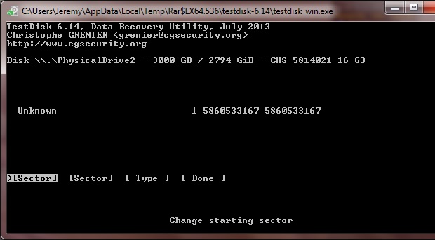

I started again but am not sure completely what to do so I mostly did the default stuff & from what I remember doing the first time. Here's screen shots of what I'm doing:
I did 'Create' and then this is the following screen:
^From there I selected the third option which is 'Physical Drive 2 - 3000 GB'
Then on the next screen:
^Here I left it on EFI/GPT and proceeded.
On the next screen I got the options you mentioned in you told me to do in your post earlier 'Run....' which I followed your instructions (Analyse, Quick Search, Stop, A to add partition) and then this is the next screen came up and you said that the starting and ending values need to match the values of the screen shot:
^Now the two values match each other but they don't match the previous screen shot I posted. I just want to make sure I'm doing everything right before I proceed. What should I do next?
