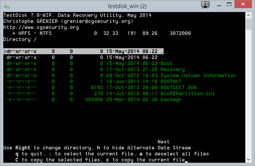

Hi, I've trying to recover an external hitachi 1tb usb3 hard disk.
It just shows the drive letter, lost the drive name, capacity info, and at disk management appears as Raw.
Testdisk via windows shows my only partition on that disk, and a limited list of the files
(i saw in the manual that the list testdisk shows is just a preview, so all the files should be recover)
I select write, and reboot.. but nothing has changed.
On Testdisk via usb linux boot, exactly the same results..
Please, what should I do??

I'm using Testdisk 7.0 on windows 7 x64.
The hard disk was ntfs, i think.. (testdisk says hpfs - ntfs)
Via windows or linux, going down with arrow key, Testdisk shows
the same incomplete file list.. maybe half of the folders.
I tried to copy some of those listed files and it worked..
So, if the write could work, i would only recover the file list i see?

Thanks Fiona, but i did'nt see no dot to be marked in the upper area on Testdisk..
I used, pressing 'a' to select all the files and then 'C' to copy all selected files
to a new 1Tb hard disk.. after hours it finally just copied the incomplete list it showed..
Please, where is that dot that would select all the drive, not just the listed files..
Re: Testdisk finds partition, writes, but nothing happens
Posted: 24 May 2014, 13:21
sry for your inconvenience!
Newer version, you can press a to select all files.
Previous or pretty old versions it was possible to select all files using that one dot!
Like on my picture and the highlighted line.
Pressing a to select all files is more clearly!

I'm using testdisk 7.0.
I might be doing something wrong..
Why the file list it shows its so incomplete ?? ( i use arrow keys up and down )
Summing up:
- deep scan
- 'a' to select all files
- 'C' to copy to a new drive
The lost partition has about 800 gb of content, testdisk recover about 150 gb.
The drive seems to have bad sectors, so I might not recover all the content.
I've been testing few different softwares as recuva, active partition recover, stellar phoenix..
Most of them list all my content; even copy to a new drive, without errors, a 50 gb single folder testdisk doesn't show..
I would like to be able to 'write' and recover the hard disk partition if it's possible
should I post some pics?
Please, what should i do?
