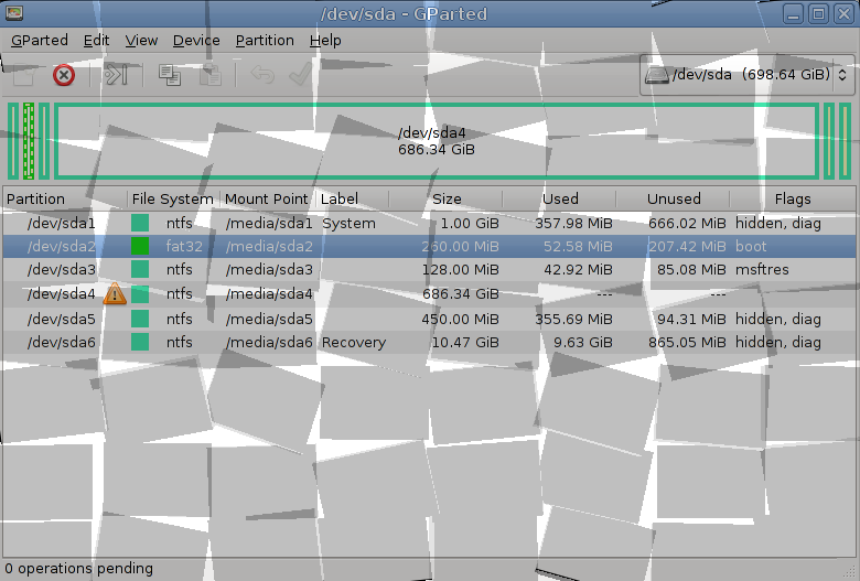

Thank you for your help. I was also looking at trying to install gpart as I have gparted and when I ask it to assist with file recovery it says I need to install gpart. I was getting errors though when said to "make" even though I have it in the right director. Seems gpart can try and help with the primary partitiion table so I can boot up.
Here is my recent test disk log.

1 P Unknown 2048 2099199 2097152 [Basic data partition]
2 P EFI System 2099200 2631679 532480 [Basic data partition]
3 P MS Reserved 2631680 2893823 262144 [Basic data partition]
4 P MS Data 2893824 1442260991 1439367168 [Basic data partition]
5 P Unknown 1442260992 1443182591 921600
6 P Unknown 1443182592 1465147391 21964800 [Basic data partition]

NTFS at 180/33/46
filesystem size 1439367168
mftmirr_lcn 10485759
NTFS, blocksize=4096, 736 GB / 686 GiB

Re: Install
Attaching a gparted screenshot to help
- screenshot.png (65.35 KiB) Viewed 9350 times
