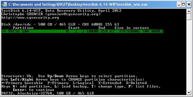

This is the partition structure. I'm currently running "rebuild BS" to add to the log. About 44% done :|

Re: MBR Messup followed by "first sectors not identical"
#4 Post by Fiona »
(EDIT-2)
*facepalm* Does this mean I posted in the wrong section? If it's a filesystem error rather than a problem with the partition (which sounds like it branches off of the filesystem) I've posted in the wrong area :geek:
Often during a diagnose, the result can be a damaged file system.
In case, I can move your topic to an appropriate forum.
Currently I recommend Testdisk 6.14WIP beta.
Your screen displays only your partition.
It's normal and standard, nothing wrong.
If your boot sector is ok, there will be nothing to do.
If it ain't broke, don't fix it.

Here's what Analyse -> Quick Search brought up:
Quick Search
Quick Search
So yeah, nothing wrong. I guess it's really just a messed up filesystem :|

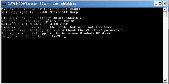

By the way, I got this:
ChkDsk non-fix?
ChkDsk non-fix?
Continue?
#6 Post by Fiona »
That's on your own risk!
Wouldn't you rather wait until you have another disk to have a try to copy your data first?
It's better to do nothing as to do something wrong.
It's in any case better than to precipitate something!
