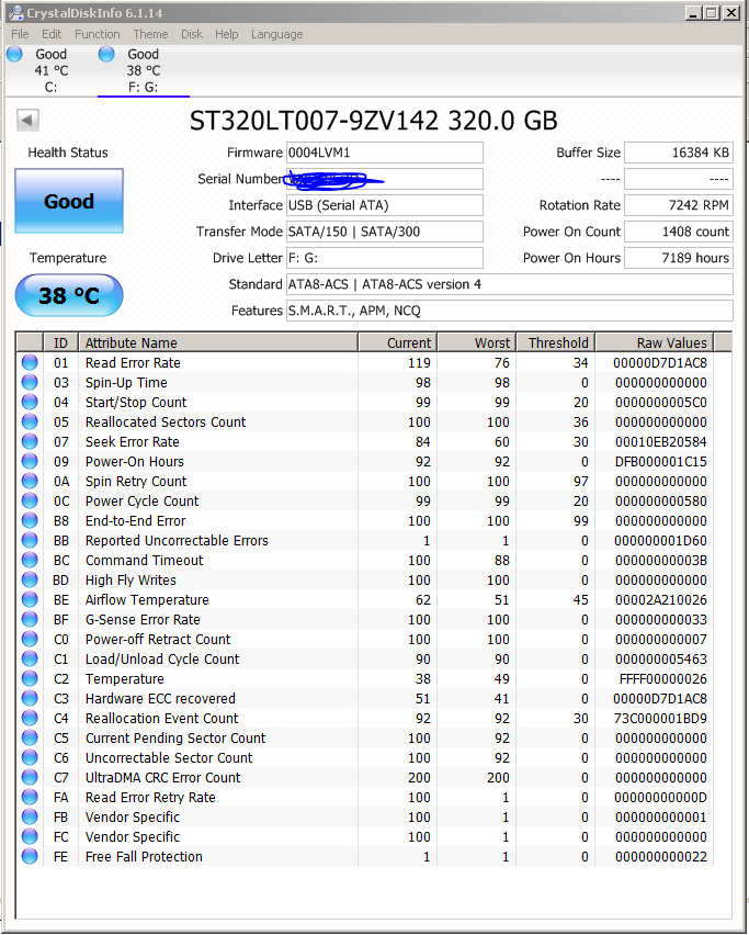

I ran SpinRite on it and there was one sector that was not recoverable (I'm not sure if that is causing the issue or not).

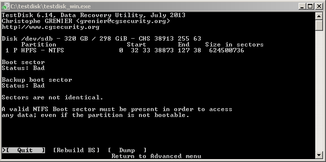

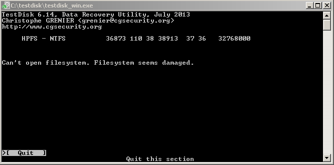

This is the current message I get when doing a quick scan on the drive.
Invalid NTFS or EXFAT boot
 0 D HPFS - NTFS          239091  60 54 393213 187  7 2475977885
So what am I asking? Have I come to the right conclusion here? I cannot do anything else without my company's IT group. If not, any suggestions on what my next steps would be?

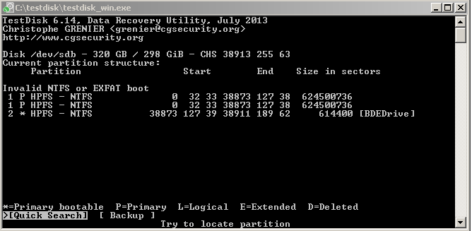

Fiona wrote:I'd need Info from TestDisk / Analyse to check your current partition table and Disk Info.
When I select the disk, TestDisk suggest that I pick Intel. When I analyze the disk, I get the following.
Which looks weird to be because the first partition is listed twice exactly the same.

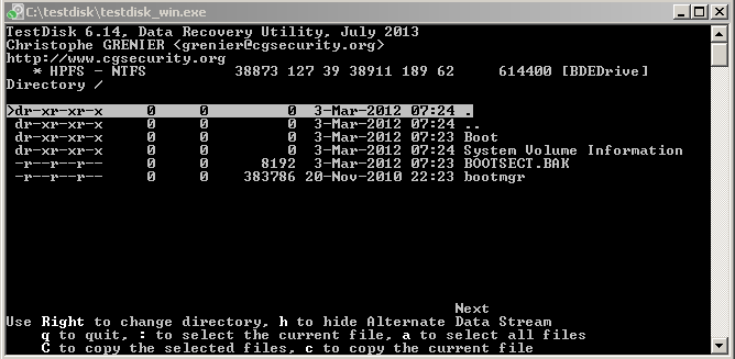

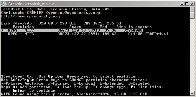

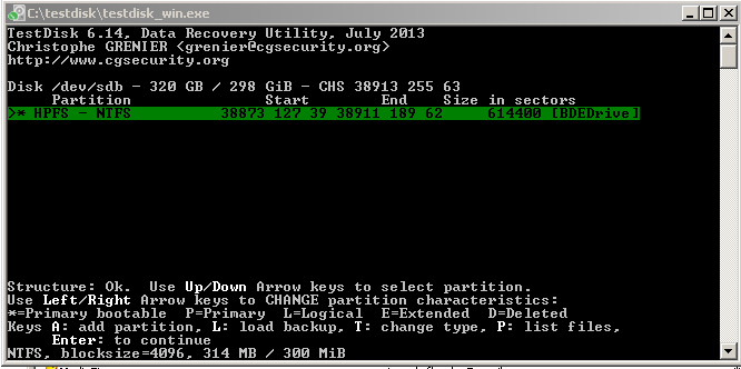

So after the quick scan, I get the following, which is missing the partition with the actual data on it.

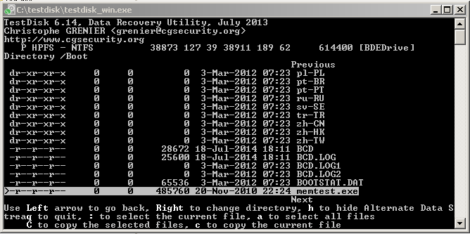

If I look at the files on BDEDrive...
I see that there are some files listed from when I started running into problem. I think that may be the last time that I tried to boot the machine since it initially happened at about 1PM EST on 18-Jul-2014.
Is there anything here that could potentially help?

And here is my TestDisk log. Any feedback is appreciated!

      85 -r--r--r--     0      0    383786 20-Nov-2010 22:23 bootmgr
dir_partition inode=97
   * HPFS - NTFS          38873 127 39 38911 189 62     614400 [BDEDrive]
     NTFS, blocksize=4096, 314 MB / 300 MiB
Directory /System Volume Information
      97 dr-xr-xr-x     0      0         0  3-Mar-2012 07:24 .
       5 dr-xr-xr-x     0      0         0  3-Mar-2012 07:24 ..
      17 dr-xr-xr-x     0      0         0 18-Jul-2014 17:01 Chkdsk
      98 -r--r--r--     0      0     20480  3-Mar-2012 07:24 tracking.log
dir_partition inode=17
Directory /System Volume Information/Chkdsk
      17 dr-xr-xr-x     0      0         0 18-Jul-2014 17:01 .
      97 dr-xr-xr-x     0      0         0  3-Mar-2012 07:24 ..
      18 -r--r--r--     0      0      4096 18-Jul-2014 17:01 Chkdsk20140718210112.log
      19 -r--r--r--     0      0      4096 18-Jul-2014 17:02 Chkdsk20140718210218.log
      20 -r--r--r--     0      0      5120 18-Jul-2014 17:03 Chkdsk20140718210315.log
      21 -r--r--r--     0      0      4096 18-Jul-2014 17:10 Chkdsk20140718211021.log
      22 -r--r--r--     0      0      3072 18-Jul-2014 17:25 Chkdsk20140718212522.log
      35 dr-xr-xr-x     0      0         0  3-Mar-2012 07:23 Boot
      97 dr-xr-xr-x     0      0         0  3-Mar-2012 07:24 System Volume Information
      96 -r--r--r--     0      0      8192  3-Mar-2012 07:23 BOOTSECT.BAK
dir_partition inode=35
Directory /Boot
      35 dr-xr-xr-x     0      0         0  3-Mar-2012 07:23 .
      86 dr-xr-xr-x     0      0         0  3-Mar-2012 07:23 Fonts
      37 dr-xr-xr-x     0      0         0  3-Mar-2012 07:23 cs-CZ
      39 dr-xr-xr-x     0      0         0  3-Mar-2012 07:23 da-DK
      41 dr-xr-xr-x     0      0         0  3-Mar-2012 07:23 de-DE
      43 dr-xr-xr-x     0      0         0  3-Mar-2012 07:23 el-GR
      45 dr-xr-xr-x     0      0         0  3-Mar-2012 07:23 en-US
      48 dr-xr-xr-x     0      0         0  3-Mar-2012 07:23 es-ES
      50 dr-xr-xr-x     0      0         0  3-Mar-2012 07:23 fi-FI
      52 dr-xr-xr-x     0      0         0  3-Mar-2012 07:23 fr-FR
      54 dr-xr-xr-x     0      0         0  3-Mar-2012 07:23 hu-HU
      56 dr-xr-xr-x     0      0         0  3-Mar-2012 07:23 it-IT
      58 dr-xr-xr-x     0      0         0  3-Mar-2012 07:23 ja-JP
      60 dr-xr-xr-x     0      0         0  3-Mar-2012 07:23 ko-KR
      63 dr-xr-xr-x     0      0         0  3-Mar-2012 07:23 nb-NO
      65 dr-xr-xr-x     0      0         0  3-Mar-2012 07:23 nl-NL
      67 dr-xr-xr-x     0      0         0  3-Mar-2012 07:23 pl-PL
      69 dr-xr-xr-x     0      0         0  3-Mar-2012 07:23 pt-BR
      71 dr-xr-xr-x     0      0         0  3-Mar-2012 07:23 pt-PT
      73 dr-xr-xr-x     0      0         0  3-Mar-2012 07:23 ru-RU
      75 dr-xr-xr-x     0      0         0  3-Mar-2012 07:23 sv-SE
      77 dr-xr-xr-x     0      0         0  3-Mar-2012 07:23 tr-TR
      79 dr-xr-xr-x     0      0         0  3-Mar-2012 07:23 zh-CN
      81 dr-xr-xr-x     0      0         0  3-Mar-2012 07:23 zh-HK
      83 dr-xr-xr-x     0      0         0  3-Mar-2012 07:23 zh-TW
      92 -r--r--r--     0      0     28672 18-Jul-2014 18:11 BCD
      93 -r--r--r--     0      0     25600 18-Jul-2014 18:11 BCD.LOG
      94 -r--r--r--     0      0         0  3-Mar-2012 07:23 BCD.LOG1
      95 -r--r--r--     0      0         0  3-Mar-2012 07:23 BCD.LOG2
      36 -r--r--r--     0      0     65536  3-Mar-2012 07:23 BOOTSTAT.DAT
      62 -r--r--r--     0      0    485760 20-Nov-2010 22:24 memtest.exe
Directory /Boot
dir_partition inode=5
   P HPFS - NTFS          38873 127 39 38911 189 62     614400 [BDEDrive]
Directory /Boot
 1 P HPFS - NTFS          38873 127 39 38911 189 62     614400 [BDEDrive]

It looks like your partition table is ok?
Invalid NTFS or EXFAT boot means that your boot sector is not ok.
If testdisk displays this message it displays the affected partition too.
That's why your partition appears twice.
But this could be a normal behavior because your boot sector is encrypted and not standard anymore.
Otherwise your disk looks ok.
Can you check your disk using crystal disk info?
Please download the portable version, because the windows installer (exe) contains adware open candy.
It's only intended to check your disk and exclude anything wrong?

Fiona wrote:It looks like your partition table is ok?
I have no idea!
Fiona wrote:Invalid NTFS or EXFAT boot means that your boot sector is not ok.
Hmmm...ok. I will dig a bit deeper into it.
Fiona wrote: Can you check your disk using crystal disk info?
I sure can! See below!

I also finished the deep scan. See below for the results.
$MFT has invalid magic.
ntfs_mft_load(): Failed.
Disk /dev/sdb - 320 GB / 298 GiB - CHS 38913 255 63
NTFS at 38873/127/39
filesystem size           614400
sectors_per_cluster       8
mft_lcn                   25600
mftmirr_lcn               2
clusters_per_mft_record   -10
NTFS at 38911/189/62
mft_lcn                   25600
mftmirr_lcn               2
     NTFS found using backup sector, blocksize=4096, 314 MB / 300 MiB
NTFS at 38913/37/36
filesystem size           32768000
mftmirr_lcn               2
     HPFS - NTFS          36873 110 38 38913  37 36   32768000
     NTFS found using backup sector, blocksize=4096, 16 GB / 15 GiB
file_pread(5,2,buffer,625143808(38913/102/38)) lseek err Invalid argument
file_pread(5,1,buffer,625143808(38913/102/38)) lseek err Invalid argument
file_pread(5,8,buffer,625142528(38913/82/18)) lseek err Invalid argument
file_pread(5,1,buffer,625142528(38913/82/18)) lseek err Invalid argument
file_pread(5,8,buffer,625142656(38913/84/20)) lseek err Invalid argument
file_pread(5,8,buffer,625142784(38913/86/22)) lseek err Invalid argument
file_pread(5,8,buffer,625142912(38913/88/24)) lseek err Invalid argument
file_pread(5,8,buffer,625143040(38913/90/26)) lseek err Invalid argument
file_pread(5,8,buffer,625143168(38913/92/28)) lseek err Invalid argument
file_pread(5,8,buffer,625143296(38913/94/30)) lseek err Invalid argument
file_pread(5,8,buffer,625143424(38913/96/32)) lseek err Invalid argument
file_pread(5,8,buffer,625143552(38913/98/34)) lseek err Invalid argument
file_pread(5,8,buffer,625143680(38913/100/36)) lseek err Invalid argument
file_pread(5,1,buffer,625143807(38913/102/37)) lseek err Invalid argument
file_pread(5,14,buffer,625143809(38913/102/39)) lseek err Invalid argument
file_pread(5,3,buffer,625143823(38913/102/53)) lseek err Invalid argument
file_pread(5,3,buffer,625143870(38913/103/37)) lseek err Invalid argument
file_pread(5,8,buffer,625143886(38913/103/53)) lseek err Invalid argument
file_pread(5,11,buffer,625143933(38913/104/37)) lseek err Invalid argument
file_pread(5,2,buffer,625145855(38913/135/6)) lseek err Invalid argument
Not an exFAT boot sector.

I also looked at the Boot Sector and found this.
I'm not sure if this is because the partition is encrypted or not. Would it be best to Rebuild BS or Dump it?
Re: Sanity Check Recovering Data w/McAfee Encrypted Hard Dri
#10 Post by Fiona »
Your disk looks absolutely ok.
TestDisk Advanced and the message that your boot sector and its backup are bad are probably a result of mcafee encryption.
If your boot sector and file system are encrypted, datarecovery software nor testdisk wouldn't probably find any reasonable result, like a valid boot sector nor file system (MFT).
There shouldn't be anything changed using testdisk.
Did you already have a look for that link above and the description how to create a win PE builder CD and have a try to decrypt your disk?
It should be done first.
