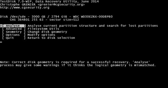

After the initial launch of Testdisk 7 (I've also tried the earlier 6XX), I selected the 3000 GB drive from the list of drives. The page said it detected a EFI GPT partition, and since I've read that that's what I should try, I selected it.
Selected EFI GPT option resized.jpg (21.72 KiB) Viewed 3391 times
Which brought up this screen:

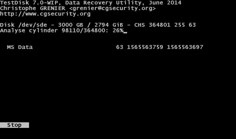

1st search after detection of EFI GPT partition resized..jpg (14.14 KiB) Viewed 3391 times
I selected Quick Search. This is a moment in time of the process.
Screen Shot after starting search.jpg (25.05 KiB) Viewed 3391 times

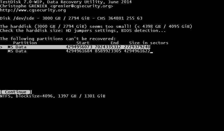

Hours after the last screen capture. Bad sectors.jpg (27.74 KiB) Viewed 3390 times
My guess is the drive has three partitions, a small Acronis bridge that allows for XP to see the larger drive, than the two real partitions. I'll be righteous and admit I'm wrong if it's explained. By no means do I think I know everything - in fact I'm struggling just to try to understand this.

1 P MS Data 63 1565563759 1565563697
