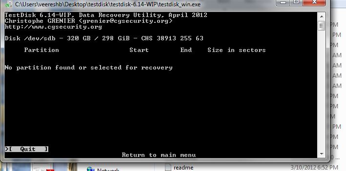

HI,
i am using win 7 run as administrator. not able recover the data.
Please help me.
Edit1:
using test disk run advanced option.I am using windows 7. run as administrator got below screen. after rebuild also.
Please help me.
Edit2;
Please help me.

external hard disk data recovery it is showing RAW & Access
- used advanced option
- Capture2.JPG (48.8 KiB) Viewed 13069 times
Re: external hard disk data recovery it is showing RAW & Acc
Looks like your file system is damaged?
Woud it be possible to run Deeper Search?
If you're using win7, it might be possible that partitions created using win7 are aligned on megabyte boundary and TestDisk find them using Deeper Search.
how to do Deeper Search?
thanks for reply.
thanks for reply.

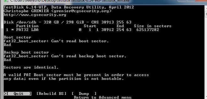

Hi Fiona,
I run Deeper Search? got below screen.
I don't know, i tried with photorec_win also.
- deeper.JPG (42.86 KiB) Viewed 13053 times
is there any chance to repair file system . RAW to NTFS. It is showing in disk management RAW. But in testdisk it is showing FAT32. any chances to repair.
I should know what file system did you have before?
It makes only sense to get your data off if you have the right file system.
RAW only means, it's unformatted, formatting doesn't help at all.
It would make your situation more difficult.
But there is a trick to diagnose it using NTFS.
But I'll only do it, if you know that exactly.
Start TestDisk.
Confirm through until you see the menu Analyse (your affected disk should be selected).
Now check the menu Type and press enter.
Check NTFS and press enter.
Confirm at Boot with enter.
Please let us know, do you see your data or an error message.
Infos will follow.
Infos will follow.
