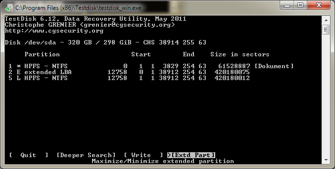

I have lost a logical partition. When I searched using TestDisk, there was a space conflict between the two partitions on the disc. I tried to fix it by using the partition backup, but I think there was something wrong with the partition backup. This is probably where I made a mistake.
Now the second partition starts at wrong place, it should start at 3830. Is there some way I can correct this? Any help appreciated!

This was the original situation reported after a search:
 1 * HPFS - NTFS              0   1  1  3829 254 63   61528887 [Dokument]
 2 E extended LBA          1280 150  7 38912 254 63  604564689
     NTFS, 31 GB / 29 GiB
   L HPFS - NTFS          12758   1  1 38912 254 63  420180012
     NTFS found using backup sector!, 215 GB / 200 GiB
 2 E extended LBA         12758   0  1 38912 254 63  420180075
 5 L HPFS - NTFS          12758   1  1 38912 254 63  420180012

I did not pay attention enough to the results so I did not notice at first that the start of the second (missing) partition ended up in the wrong place.
I think there was a problem with the backup partition table. Actually I hade another configuration on the drive a while ago with three partitions. When is the backup partition table written to?
I have tried Deeper Search a couple of times again, I get the result in the screenshot of the first post each time.

It would be a possibility to add a partition manually, assuming that you used the whole space as a second partition and have a boot sector diagnose.
But it would only make sense, if you didn't overwrite any data from your previous second partition.
Did you overwrite a part of your second partition?
