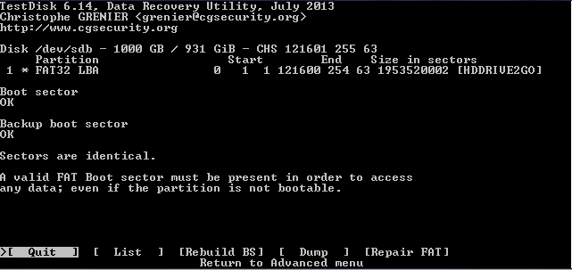

I accidentally plugged out my external hard drive too soon, without safely disconnecting it first and the next time i plugged it in, i was asked to format it.
I had never partitioned it and just moved lots of files onto it so i could delete them from my laptop.
At first, boot sectors were not identical, but i think i fixed that with orgBS. I restarted everything, but was still asked to format it.
I can see all of my files in list, so i don't think anything is lost, i just don't know how to access it anymore!
(There are A LOT of files though, so i couldn't just copy them back onto my laptop.)
Any idea where the problem may lie and how to fix it? :/
Possibly a simple problem?

Re: Possibly a simple problem?
It's probably not as simple.Possibly a simple problem?
To sync the backup of a boot sector it's not as much helpful and often indicates a faulty file system.At first, boot sectors were not identical, but i think i fixed that with orgBS. I restarted everything, but was still asked to format it.
If testdisk lists your data you should copy/backup them first.
At the bottom of the screen, you'll find all the copy commands.
After backing up your data you can have a try to repair your file system running:
chkdsk driveletter: /r
within your command prompt with administrator privileges.
I ran it and all i got was:
"The type of the file system is FAT32.
Cannot read boot sector."
So it is the boot sector that is the problem. I think making them identical did not quite fix the problem. All i did was orgBS (as previously advised by someone here) but maybe there was something else i had to do?
Might be possible to run testdisk / advanced / boot and RebuildBS.
Are the boot sector and its backup are identical?
Can you list your files?
Please don't use the menu "WRITE" and repair FAT.
Repair FAT is only intended in conjuction with chkdsk if chkdsk doesn't work.
Repair FAT could modify your file system and should be avoided.
I ran RebuildBS and got this (see attachment below).
And yes, i can list all files and it does say that boots are ok and are identical, but they clearly must not be? :s
Should i dump it? Or write?
Extrapolated boot sector and your boot sector are different.
That's why it's an idea to write your boot sector to to have a try to get access to your files.
You must restart windows after changes.
But if your file syestem is still faulty/dirty it might be possible that windows hangs, if windows tries to access your disk
In case you can still access it through testdisk.
Also, it might be possible to repeat a chkdsk diagnose without parameters, to get info about your file system.
How do i make the boot sectors the same?
I ran RebuildBS, then Write. Restarted my computer. Did chkdsk g: and got the same:
Nothing works!
Nothing works!
Did you already write your boot sector after RebuildBS?
This boot sector is different to your current one.
So it might be possible that you can access your data and if your file system is still faulty to run chkdsk.
It's something to try!
It's not important that your boot sector and it's backup are the same and synced
It's important that your boot sector is repaired and valid!
