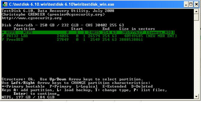

Ok, just selecting "Analyze" does not show any partitions on the hard drive.
However, when I run a Quick search, it finds the 3 partitions on there.
I have uploaded a screenshot showing the details:
EDIT: And I have hit P on both the NTFS and FAT 32 partition to list the files on there, and it shows everything the way I remember it, so it looks like the filesystems are still intact. :)
But I still have no idea what to do to make the partitions accessible from my OSes. Any ideas?
Thanks in advance.
Re: Testdisk screwed up my external HDD
#7 Post by Fiona »
Looks like, that you don't have any partition in your partition table.
To make your partitions accessible to your OS you should register them to your partition table.
Currently I've no idea about your FreeBSD-partition and it does'nt start right after your FAT32-Partition.
But if it's ok, easily at your last screen hit enter;
http://forum.cgsecurity.org/phpBB3/down ... iew&id=421
Mark Write and confirm with enter and y.
Close TestDisk using Quit and restart your PC.
Please let me know.

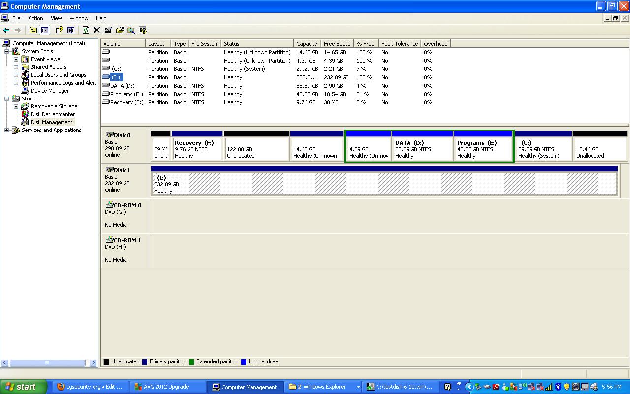

Ok, I did that, and now on the Analyze screen, it shows the 3 partitions without searching for them.
However, in Disk Management, it only shows one 232.89 GB partition with a drive letter I
on the hard drive. And when attempting to access I: from My Computer, it asks if I want
to format it, which I obviously don't, so I hit No.
Now what?
#9 Post by Fiona »
Would it be possible to use version 6.14-32bit?
TestDisk 6.10 is a pretty old one.
Might be possible that your partition table is messed up.
In any case, windows disk management console displays a wrong partition.
Normally TestDisk should display only that partition?
Could you delete your unformatted partition from your disk management console?
Can you make a backup from your partition table in Testdisk?
You'll find at at Analyse.
Please close any background process like Antivirus etc.. which can prevent TestDisk from writing a partition table.
Repeat your diagnose and Write your partitions again.
Please let me know if this one was working for you?

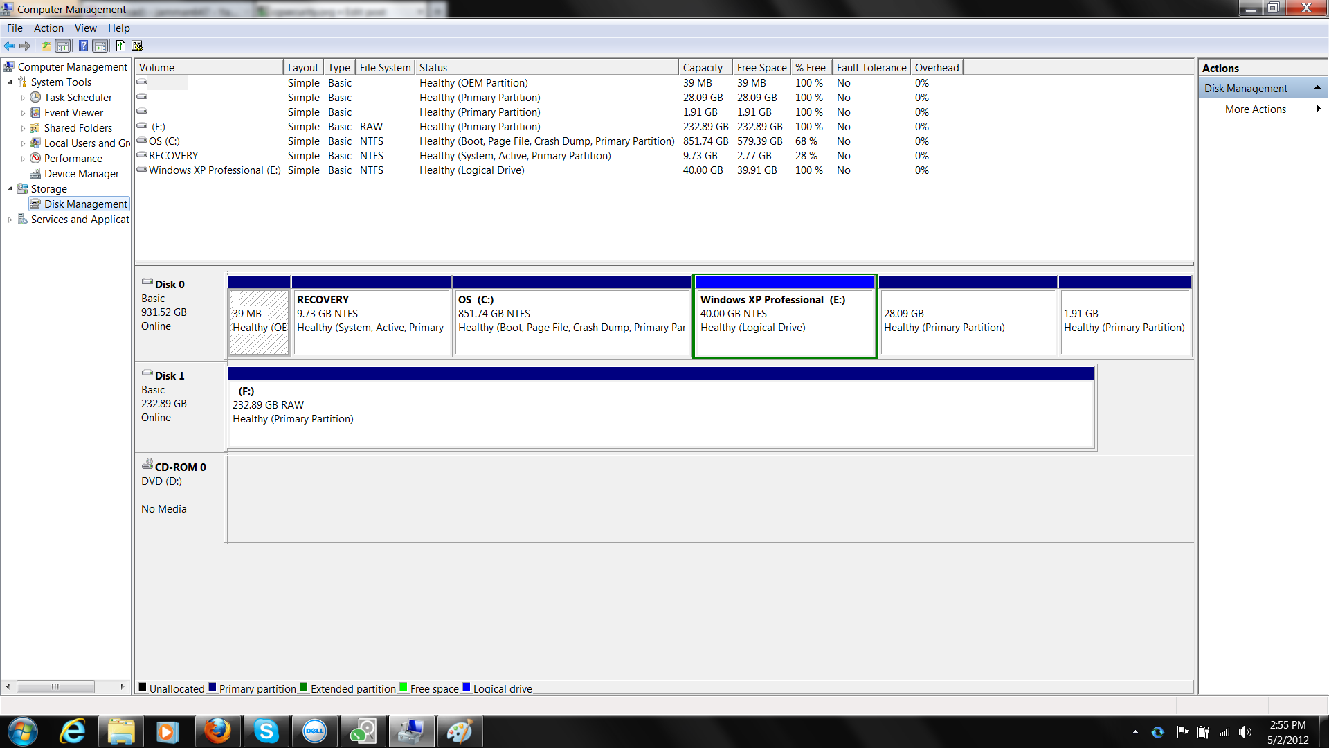

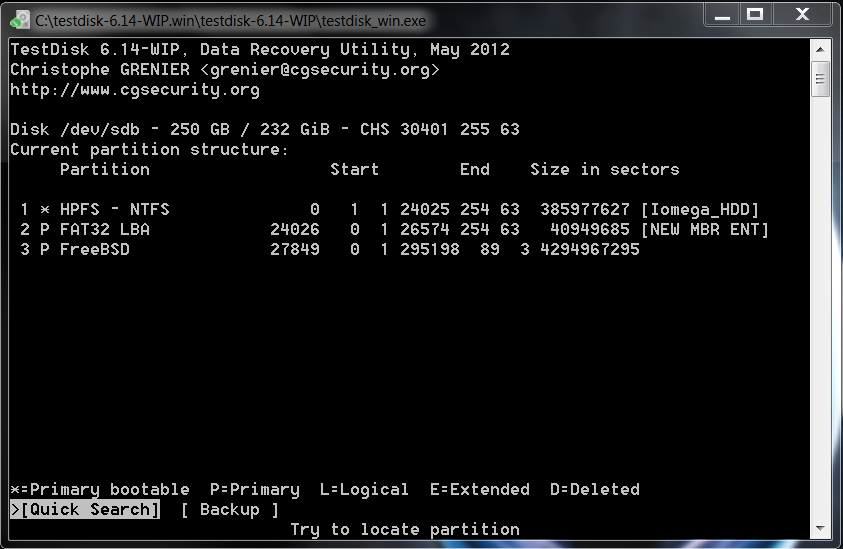

Ok, I created an image for each partition shown by Testdisk (selecting to append to file, instead of creating a different one for each partition), just to be on the safe side, then I deleted the partition from Disk Management (in W7 of my other computer) which brought the disk to 232.89 "unformatted space" from DM's perspective. Next I started up Testdisk again, which now didn't show any partitions at the Analyze screen, so I ran Quick search again, and it located the 3 partitions again. Then I selected "Write" to the partitions to the partition table of the disk, and was instructed to reboot, which I did. Next, I opened up DM again, which now showed there being once more a 232.89 healthy RAW F: partition (??), which of course wants to be formatted when trying to open it in Computer. So I have attached two screenshots showing where I'm at now.
Any further help would be much appreciated.
