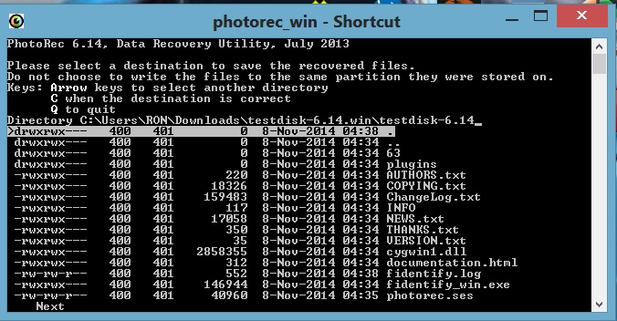

OK, I get to this point using PhotoRecovery, and do not know what I need to do next ?? The screen shot shows where I get stumped. What do I do next ??

Re: OS wrote over wrong HD
It is written:
1. select a destination to recover files using arrows (you must choice another disk or partition)
2. press "C" to confirm destination
3. press "Q" to quit
Yes sir, I understand that is what is required to continue with the recovery process.
At this point I am completely lost though, so please bear with me.....
Am I to enter a new command line, to get the recovered information to be saved ?? If so, what do I enter ?? Or am I just to enter a drive letter, where the curser is blinking ??
This has me completely lost ??
You have to follow instructions. Did you read the guides I have linked?
Now you have to select the path of recovered files; to do so you have to mount another disk (for example external usb disk) or select another free partition of your damaged disk (if eny) where no previous important data is present. After that, testdisk will show you the detected partition after the quickscan; so you have to select this partition and press "P" to list the lost files (if eny). Then follow the instructions shown by program.
I hope I've been clearer.
Yes Nick, I did read over the directions you linked me to, and I printed them off, so I can follow them as I'm going through the process.
I hate to say, this is way over my head, and I am completely lost. I think I understand a little more with your last post. I will see if I can get it done correctly this time...
I've always struggled learning with books. I learn best by example, which is part of the reason this is so hard for me.
Thanks for your help, and your patients with me !!
"EDIT" As I said I've never been good at bookwork. I think I just figured out part of my problem. I've been using the Photorecover software, with TestDisk directions.....No wonder the screen shots do not look like the picture in the directions.....
