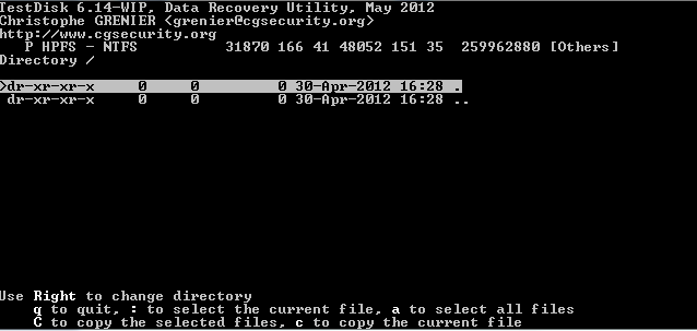

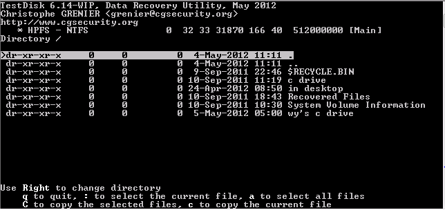

You mean this?
- Capture3.PNG (6.46 KiB) Viewed 12772 times
When i clicked quick search it shows this.

Re: Partition drive is not accessible!!
Posted: 05 May 2012, 17:53
At least your partition table looks ok.

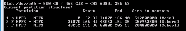

this is what happens when i press p
- Capture4.PNG (16.33 KiB) Viewed 12765 times

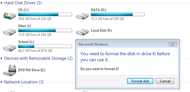

this is what happens when i clicked onto 'others'/K: drive actually it can't be accessed. but i do not know why it ask for formatting. :X
Posted: 05 May 2012, 20:46
If you check your partition "others" in testdisk, and press p, did you see your data or an error message.
If you're able to list your data in TestDisk you should copy them to another intact drive/partition.
At the bottom of the screen you'll find the commands.
Standard path is your testdisk folder.
I don't recommend to copy the entire disk.
Recycler and System volume information are system folders and can cause trouble.
Everything else can be copied.

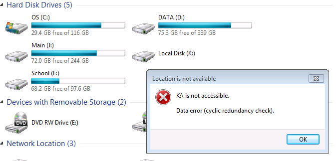

by unknownmaster80
This is what i get when i go press p in 'others' K: drive. I can't see my info in the drive. But other drives can see.
- Capture1.PNG (12.26 KiB) Viewed 12749 times
Posted: 06 May 2012, 08:18
Unfortunately it looks like that your file system from your K:-drive (others) is damaged.
CRC-error (Cyclic Redundancy Check) means that the checksum is not valid and indicates a damaged file system.
Windows doesn't display the label "others" but only local disk.
A safe solution would be datarecovery software.

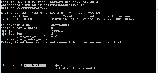

by unknownmaster80
Hi, You said to Rebuild BS. but after that this page shows up. so am i suppose to list or dump it?
