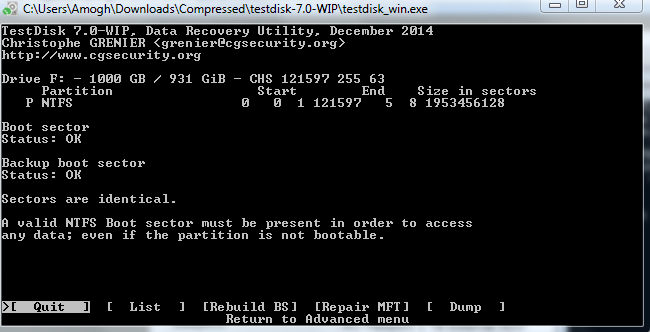

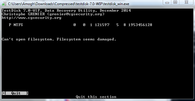

Hello Guys,
Disclaimer: I am a complete novice at any kind of data or partition recovery. I don't even know what is wrong with my disk except for the fact that it is not working (F: is the drive in question here)
I downloaded TestDisk and ran some basic tests and below are the screenshots
I would really appreciate any inputs / steps to help me recover data from this disk.
Thanks a lot!
Amogh

Run "cmd" (right click run as administrator) and type "chkdsk /f f:". What is the results ?

I am sorry to hear about your issue. You can run Data Lifeguard Diagnostic tool to check your HDD for bad sectors. You can download it here for free: http://products.wdc.com/support/kb.ashx?id=rFXnav
Run the extended test and let us know what the results are. Some logical errors on the drive can be repaired with this programm. If this does not help you could try with a data recovery software.

I am stuck at the same level than your original post:
> Boot sector and Backup boot sector are both OK but "A valid NTFS Boot sector must be present"
> "Can't open filesystem. Filesystem seems damaged"
I've been advised to run the "chkdsk /f" command but I read that this can cause some damages. How did it go for you? Did you lose some data?
