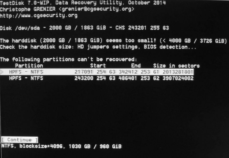

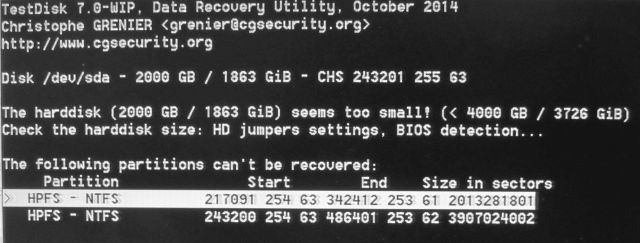

Bootdrive WD20-EURX-64HYZY0
has WINXP with 4 Partitions: Its the backupdrive where i had 200gb acronis-secure zone-data.
they were gone after backup. Original was messed up be me by mistakes.
C - 70gb
D - 633gb not accessible
E- 960 gb
F- 200gb Acronis Secure Zone(no data, see above)
Testdisk deap search went trought.
except C and E i cannot show files.
filesystem damaged.

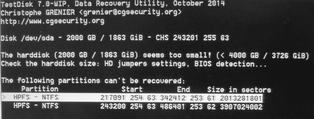

here are the first 3(limit per thread) of 8 screenshots.
hope i dont confuse you. pls tell me if images are too big-some are 800x600.
Before executing your suggestions i will clone it with clonezilla.
Testdisk_WD20-EURX-64HYZY0

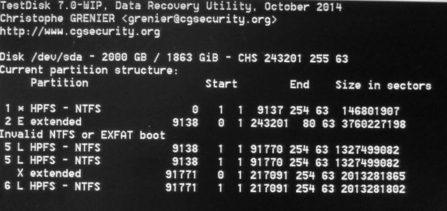

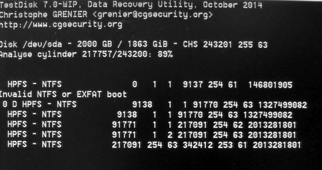

Next screenshots 4,5,6 of 8.

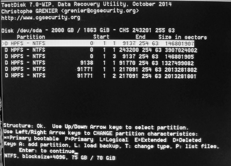

Last 2 of 8 screenshots

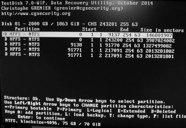

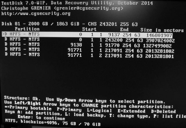

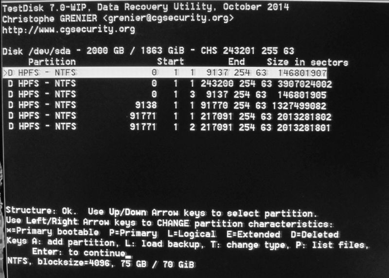

Did a new scan. Here are the results of the 5 partitions shown:
I have four partitions
C primary
D, E, F extended
D is overlapping C
i cant see these data.
Here is what they show
0 1 1 9137 254 63 146801907 Winxp
0 1 1 243200 254 63 39070124002 P, files, cant open filesystem, Filesystem seems damaged
9138 1 1 91770 254 63 1327499082 no P option/ files to check
91771 1 1 217091 254 63 2013281802 P, files visible and backed up, Not the ones i want to see
91771 1 2 217091 254 63 2013281801 P, files, cant open filesystem, Filesystem seems damaged
Will clone drive before doing next steps.
btw: with clonezilla i could only clone 1: 1 from 500gb to 1tb. how to expand? at least i have now space to save data to. Thank you very much for explanations to understand what is wrong and what must be done to make partitions visible again. btw: did not make changings after last scan, shown screenshots.
