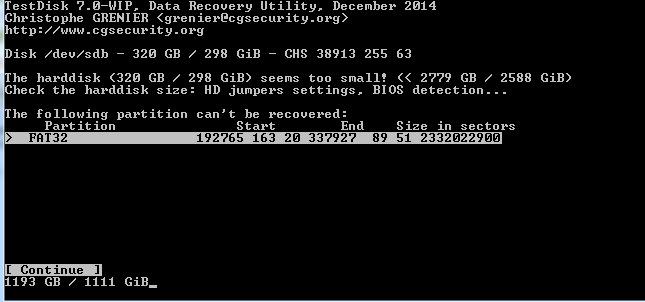

Can someone help me on what to do to recover this partition? This is the output I get when I ran the deep scan on testdisk. This is an external 230GB SATA drive.

Press Continue...

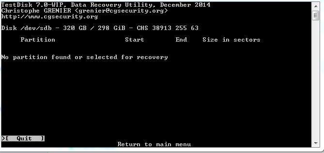

It then asks me to build the partition...I don't know how to build it....
This is what I get when I press next. I have no backup to load from, and if I try to add, IDK what the start & end should be, and I DO NOT want to loose the data.

After I do a deep scan i again get a message that the partition is damaged and can not be recovered, well I hit enter, and I then get this message
