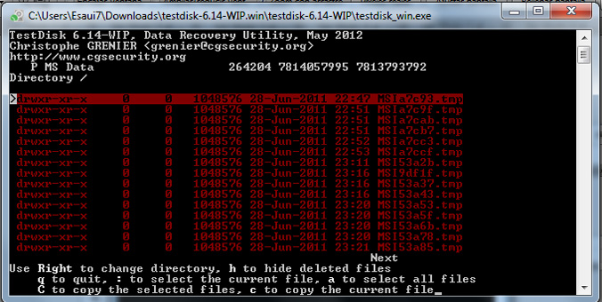

Also you'll be able to copy files using TestDisk
Your files on this screen are red colored;
http://forum.cgsecurity.org/phpBB3/down ... php?id=488
Red colored files are deleted files.
If you don't need them, easily press h for hide.
To copy/backup your files to another intact disk/partition, you'll find all the commands at the bottom of the screen.

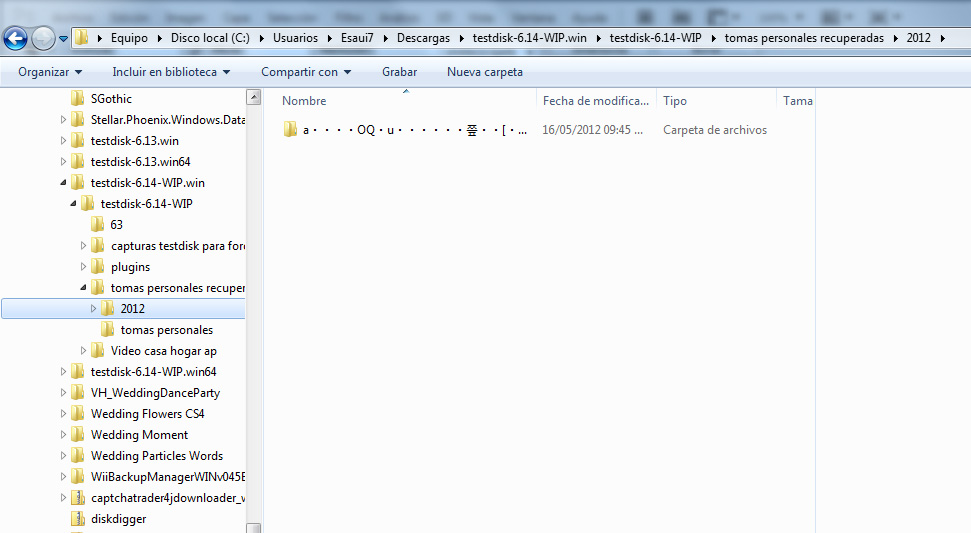

Testdisk does not display all files that had, anyway, i try to recover a file but the recovered folder name is rare and no files in there...
