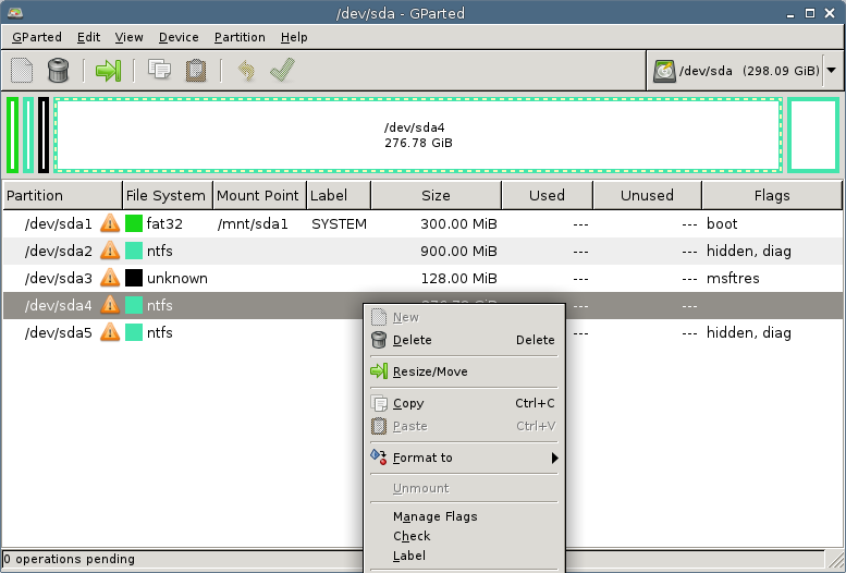

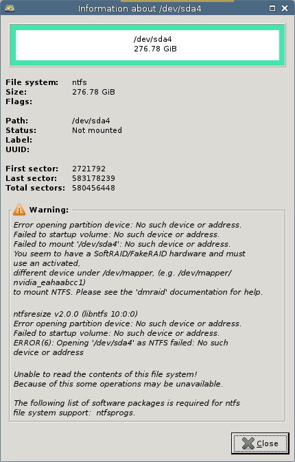

gparted can see it, but cannot mount. see attached pictures.

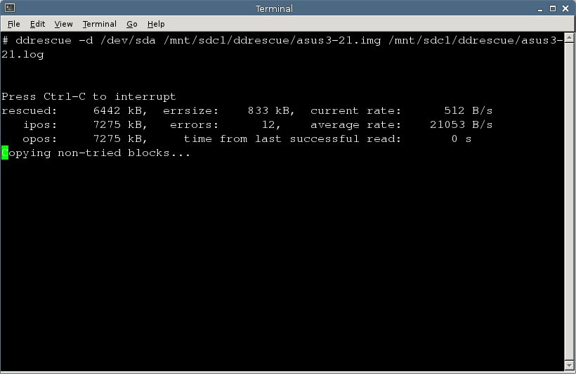

however, when i ran thee following command, ddrescue DID begin to image the entire drive. Is this process doomed to fail, since the partitions cannot be mounted?
attached pic shows this process happening in terminal window.
thx!
ddrescue -d /dev/sda /mnt/sdc1/ddrescue/asus3-21.img /mnt/sdc1/ddrescue/asus3-21.logthx!

seems to be working, but taking forever. i only need to recover that one partition, not the whole drive.
can i use the "First Sector" value as-is for the ddrescue -i option? Or do i need to divide by 8 or 512 or something?
thx
