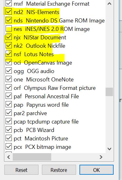

files I am trying to recover are NEF - nikon raw files. In your wiki http://www.cgsecurity.org/wiki/File_For ... Multimedia you have this format listed, but when I go to file formats in photorec I cannot find this.
I don't want to recover tons of other files since i now for sure i need only nef one.

Re: Segmentation fault
Posted: 08 Aug 2017, 09:43
In FileOpts, you can select the file family you want to recover (ie. TIFF pour .nef).
By default, PhotoRec only recover deleted files when a partition (FAT, exFAT, NTFS, ext2/3/4) is selected but if the disk has been defragmented in the past, there may be deleted copies of the files.
