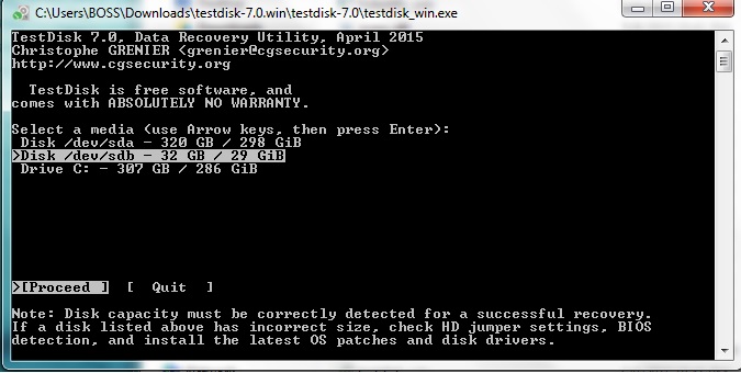

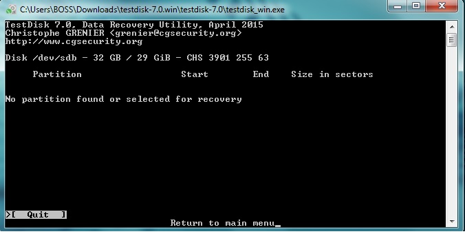

Re: How to Back up empty looking MicroSD Before using Testdi
Posted: 26 May 2015, 08:40
by kapon
Fiona,

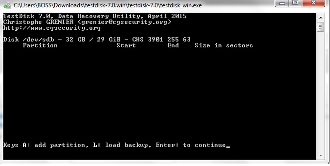

Unfortunately I cant see any partition in my disk.

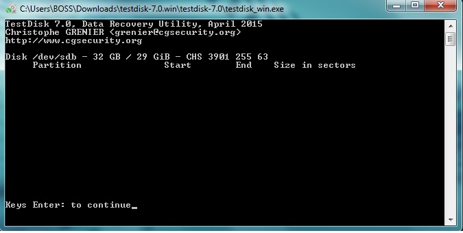

Here are the screen shots from the processes al the way to the result of "Deeper Search":
Initial Test Disk Screen
Initial Screen testdisk.jpg (70.4 KiB) Viewed 9261 times

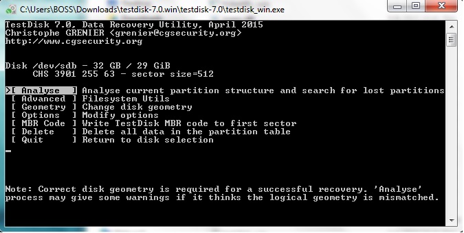

Before Analyze
Before Analyze
Before Analyze.jpg (68.84 KiB) Viewed 9261 times
Analyze Result
Analyze Result
Analyze Result.jpg (53.65 KiB) Viewed 9261 times
Picture with the following reply will be Deeper Search result-->

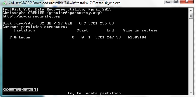

Here is the Deeper Search Result:
After Deeper Search.jpg (44.83 KiB) Viewed 9261 times
So testdisk cant find partition. What should I do next to access and recover files in my microSD card?

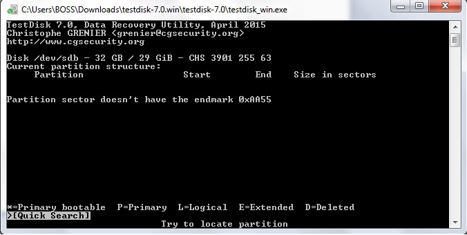

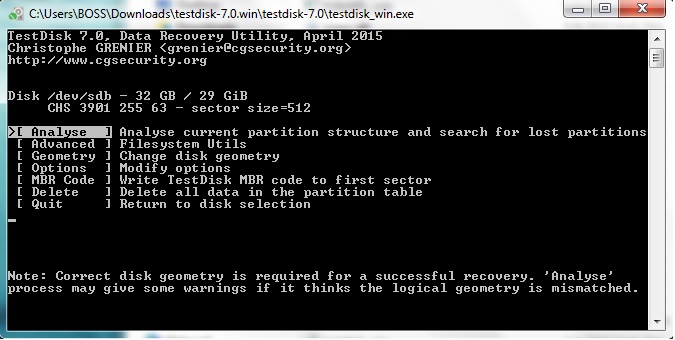

I did select Partition Table type "None" and then did Analyze. Testdisk could not find any partition table after search and Deeper Search. Here are the screenshots of the process:
I chose None and clicked Analyze
"None"Chosen and Clicked Analyze
None clicked Analyze.jpg (45.2 KiB) Viewed 9233 times
After Deeper Search
After Deeper Search
None_After deeper search1_1.jpg (41.05 KiB) Viewed 9233 times
After Deeper Search
After Deeper Search
None After Deper search1_2.jpg (42.73 KiB) Viewed 9233 times
So except for the initial screenshot I don't see any data about partition.
What should I do next?
