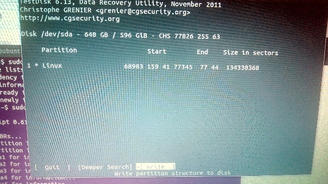

* I now wanted to get my Ubuntu back. I used liveCD to 'try Ubuntu' + install + run testdisk. Here, testdisk did find my Linux partition. I went down the directories in testdisc to make sure, filenames did show up!
But before initiating this partition recovery I changed D to *.(will send screenshots). It immediately asked me to reboot which was surprising (took no time for recovery, is it done that fast?).

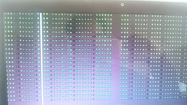

* if I insert my previously working liveCD now to 'try ubuntu', it wouldn't work. I see garbled green colored text on the Ubuntu startup screen which i guesd roughly reads 'edd: error ???? reading sector #####'(image attached).

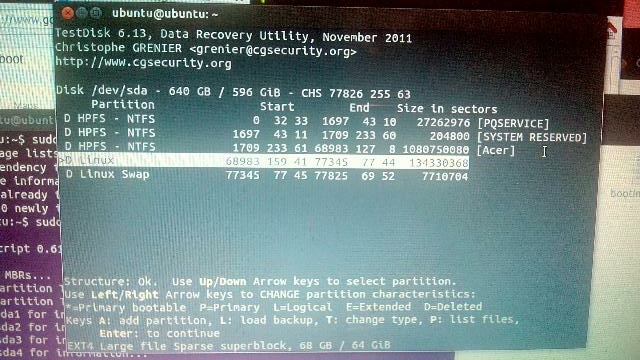

Thanks for your positive reply. How do I get you that necessary info? Please see if the photographs attached suffice, or if more info is needed.
First overview
First overview
Overview upon search?
Secondly, about livecd boot (to attempt recover partitions), in regards to error reading sector problem, some posts online suggest that a different livecd needs to be used. Any thoughts?

Your photos are suffice.
Your current partition structure (partition table) is ok except your Linux partition is missing.
But testdisk found it running Quick Search
Before you could recover it, you should have a try to list your files.
Both partitions Linux and Swap should be set to L for logical and you can use Write to recover all partitions.

* Ubuntu CD wouldn't work, says edd error reading sector
Might be an idea to create another ubuntu cd?

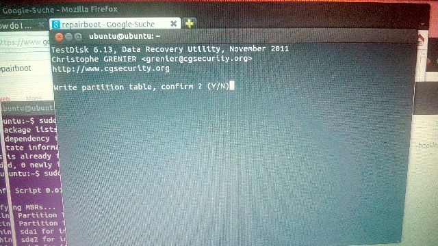

No... I did not know how to use the tool correctly. I had only asked it to write Linux, that too with * and NOT D.
Write screen was like this...
And then this:
AndAthen this...

#10 Post by Fiona »
Check your BIOS and boot option that you´re booting from the right device/disk:
Is your disk your boot device?
Instruction on how to recover your partitions
The status of your current partitions have all the status D for deleted.
http://forum.cgsecurity.org/phpBB3/down ... hp?id=3074
But you have to write all partitions into your partition table.
You should mark each partition and use your left or right arrow key on your keyboard to set your partitions in right order as explained below:
You can watch it at the left side.
Mark your first Recovery partition and set it to P for primary only.
Set your Windows Reserved partition to star for primary active andf bootable.
Set your Acer partition to P for primary.
Set your Linux partition to L for logical and your Swap partition too.
Please note:
You have 5 partitions including your Linux Swap.
Intel MBR can have up to 4 primary partitions or three primary and 1 Extended partition for logical partitions.
Only primary partitions can be active bootable.
Might be possible that Grub as a bootmanager can start a logical partition too?
