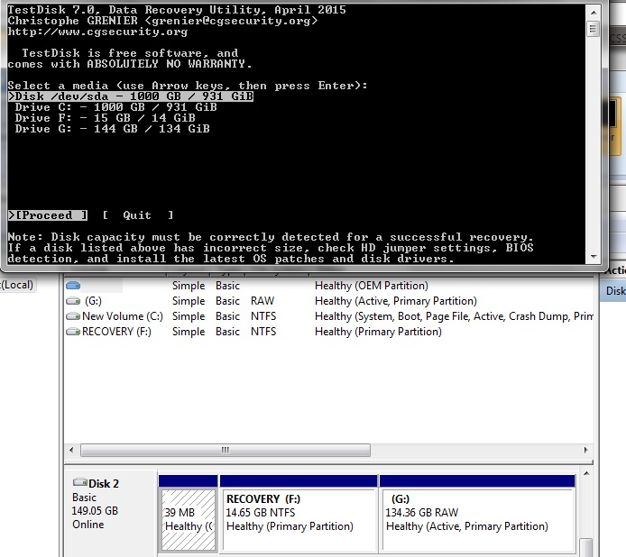

Hi
I've got a WD Scorpio Blue 150 gb disk that turned RAW from NTFS on one of its drives. In using Test Disk, it doesn't list the disk but does list the 2 drives (F & G). Disk Management can see it but I have no Security Tab in Properties for the RAW drive G:
Analyse shows nothing but Read Error for drive G: and after scanning reports No Partition Selected.
Any ideas why or how to get Test Disk to "see" the disk? Any suggestions are welcomed.
Thanks

I've no idea why your disk doesn't appear in your disk selection?
Can you test testdisk 7.1WIP 32bit?
To work around your problem:

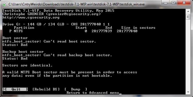

Can you run TestDisk, select your drive G: / partition table type None / Advanced / Boot and upload another photo?
Use the menu List to have a try to list your files.
Please let me know.
Re: Disk not listed
Posted: 22 Jun 2015, 12:57
by JJason4
Hi Fiona,
Here's the results

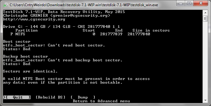

Can you run RebuildBS?
As long as you don't use Write, nothing will be changed.
If it's successful and the menu List becomes available, you can try to list your files.

I apologize. No, it did not list the disk. The image in the earlier post only had to do with drive G:.
After running Rebuild BS this was the result.
I tried List and it reported "Can't open file system. File system seems damaged."
Any ideas?
