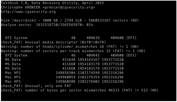

I'm new here as well and left my testdisk session running for 4 days. The 1% did not change but the sectors searched kept changing - in comparison to the total number of sectors - so I left it running. The confusing thing for me was that it eventually exceeded the total number of sectors... I expected testdisk to stop and generate a report.
Screen Shot 2015-06-29 at 6.03.31 am.png (35.75 KiB) Viewed 9872 times
So, I have no answers for you but you are not alone!

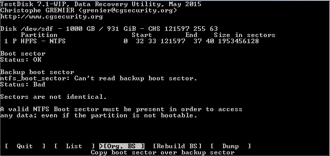

Re: Quick Search and Read Errors
Posted: 03 Jul 2015, 06:38
I assume it's your 1 TB disk:
http://forum.cgsecurity.org/phpBB3/down ... hp?id=3194
It's only necessary to select your affected Disk.
Looks like that the backup of your boot sector is damaged.
Don't use OrgBS to avoid any modification.
Can you run RebuildBS and if it was succesful to use the menu List to have another try to list your files?
